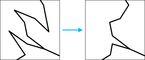

Remove Cutback Vertices tool illustration
Roads before and after running Remove Cutback Vertices with a 40 degree minimum angle are shown. One cutback remains because it touches another feature.
