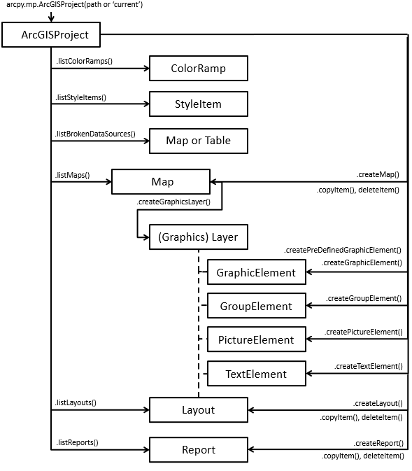

The ArcGISProject object is usually one of the first object references created in a map automation script because it is the main entry point to access most other objects in an ArcGIS Pro project. A project is referenced using the ArcGISProject function. Its properties allow you to get or set project settings such as defaultGeodatabase, defaultToolbox, documentVersion, filePath, and others. Its methods allow you to manage project items such as updateFolderConnections, updateDatabases, createMap, and createLayout, and copy or delete some project items using the copyItem or deleteItem methods, respectively.
Once you have a reference to an ArcGISProject object, you can access other objects using a number of list functions. For example, you can access a Map object using the listMaps method or a Layout object and a Report object using the listLayouts and listReports methods, respectively.
The following diagram illustrates, along the left side, the use of list functions for navigating and referencing the objects in a project. The diagram is only an example and does not display a complete set of objects and list methods.
An example ArcGISProject object model diagram illustrating the use of list and create functions.
The diagram above, along the right side, also illustrates many of the create functions. For example, you can use createMap to create a Map object, createLayout to create a Layout object, or createReport to create a Report object.
