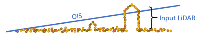

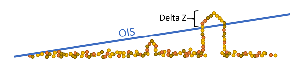

    Delta Z
  • This tool requires an ArcGIS 3D Analyst extension license.
  • The input LAS dataset and .las files must be in a projected coordinate system. You can use the Project LAS tool to project the LAS dataset or .las files.
  • The optional output .las files will match the LAS version, point record format, and compression of the input.
  • The optional .las files and LAS dataset file will overwrite any files that share the same names.

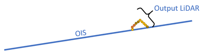

  • When specified to generate the LAS output, the .las file that is generated will contain the lidar points from the input penetrating the OIS surface.
    Delta Z Input Lidar
    Delta Z Output Lidar
