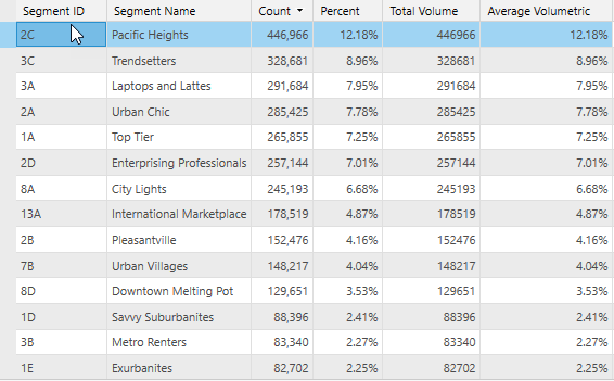

  • Optimally, the input table should contain the Segment ID, Segment Name, Count, and Percent fields. If the table was built with volumetric data, the Total Volume and Average Volumetric fields should also be included.
    Import segmentation table
    Подсказка:
    Remove any additional fields that exist in the input table before importing it.
