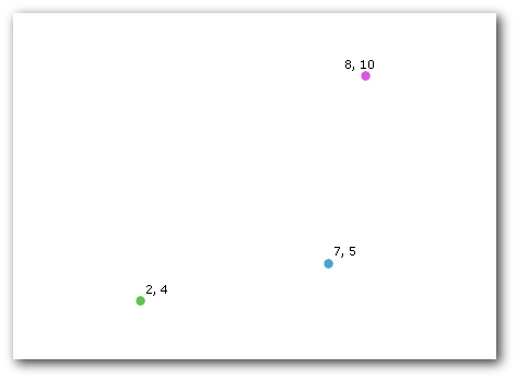

读取点几何
以下示例使用 SearchCursor 打印所有要素的坐标。
点要素类上的搜索光标
import arcpy
infc = arcpy.GetParameterAsText(0)
# Enter for loop for each feature
for row in arcpy.da.SearchCursor(infc, ["SHAPE@XY"]):
 # Print x,y coordinates of each point feature
 x, y = row[0]
 print("{}, {}".format(x, y))
点几何
对于上述要素类,脚本将返回以下信息:
2.0 4.0
8.0 10.0
7.0 5.0

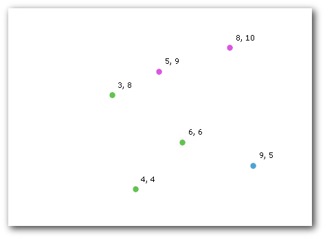

读取多点几何
多点要素类上的搜索光标
import arcpy
for row in arcpy.da.SearchCursor(infc, ["OID@", "SHAPE@"]):
 # Print the current multipoint's ID
 print("Feature {}:".format(row[0]))
 # For each point in the multipoint feature,
 #  print the x,y coordinates
 for pnt in row[1]:
     print("{}, {}".format(pnt.X, pnt.Y))
多点几何
对于上述要素类,脚本将返回以下信息:
Feature 0:
3.0 8.0
4.0 4.0
6.0 6.0
Feature 1:
5.0 9.0
8.0 10.0
Feature 2:
9.0 5.0

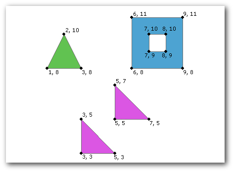

读取折线或面几何
面或线要素类上的搜索光标
import arcpy
 # Print the current polygon or polyline's ID
 partnum = 0
 # Step through each part of the feature
 for part in row[1]:
     # Print the part number
     print("Part {}:".format(partnum))
     # Step through each vertex in the feature
     for pnt in part:
         if pnt:
             # Print x,y coordinates of current point
         else:
             # If pnt is None, this represents an interior ring
             print("Interior Ring:")
     partnum += 1
面几何
对于上述要素类,脚本将返回以下信息: 要素 0 是单部分面,要素 1 是两部分面,要素 2 是具有内部环的单部分面。
Feature 0:
Part 0:
3.0 8.0
1.0 8.0
2.0 10.0
3.0 8.0
Feature 1:
Part 0:
5.0 3.0
3.0 3.0
3.0 5.0
5.0 3.0
Part 1:
7.0 5.0
5.0 5.0
5.0 7.0
7.0 5.0
Feature 2:
Part 0:
9.0 11.0
9.0 8.0
6.0 8.0
6.0 11.0
9.0 11.0
Interior Ring:
7.0 10.0
7.0 9.0
8.0 9.0
8.0 10.0
7.0 10.0
