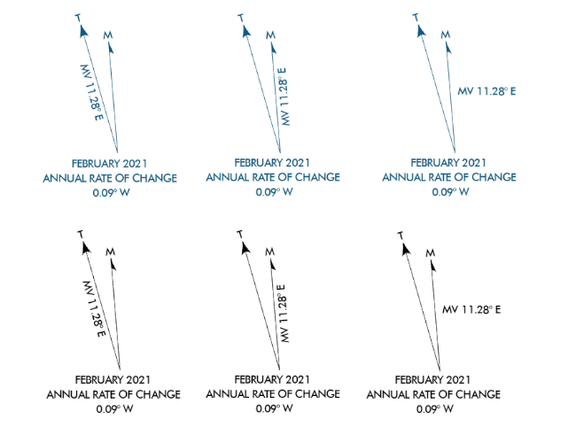

Aviation north arrow gallery

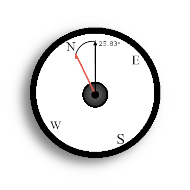

Magnetic variance
Magnetic variance refers to the angular distance between magnetic north and true north. A compass or other navigational equipment that relies on magnetic north must be calibrated to specify which direction is true north. Since magnetic variance changes over time and depending on the latitude and longitude, it is crucial that aeronautical charts show the correct magnetic variance to allow for the safe travel of aircraft.
A compass calibrated using magnetic variance

Variation text communicates critical information about the angles between the true north arrow, the grid north arrow, and the magnetic north arrow. These measurements are necessary for tuning navigational equipment on an aircraft.
  1. Click the Variation Display Side drop-down arrow and choose a display method.
    • Right—The text appears to the right of the aviation north arrow.
    • Left—The text appears to the left of the aviation north arrow.
  2. Check the Align Variation to Line check box to vertically align the text to the true north arrow's line.
  3. Check the Display Year check box to turn on and off the visibility of the year the declination was recorded.
    注:
    The default value for the display year is derived from the Declination option in the Declination section.
  4. Check the Display Year in Paranthesis check box to append parentheses around the displayed year.
  5. Set the symbology for the text next to Text Symbol.
  6. Type a value into the Magnetic Identifier Text text box.
    The value you type into the Magnetic Identifier Text text box appears next to the recorded magnetic variance.
  7. Type a value into the Grid Identifier Text text box.
    The value you type into the Grid Identifier Text text box appears next to the angle of the grid north arrow.
Variation Text options
