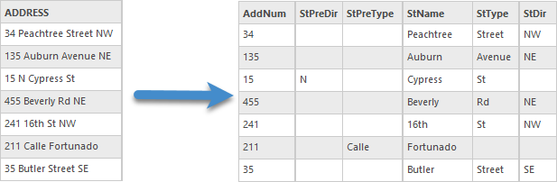

插图
Split Address Into Components tool illustration
