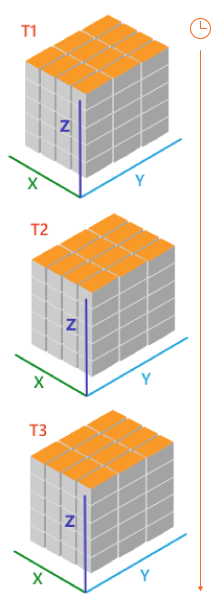

X,Y,Z,T
X,Y,Z,T
float x
:units
dimensions:
time = 2;
z = 3;
y = 33;
x = 33;
variables:
float time(time=2);
  :units = "hours since
1990-01-01T00:00:00";
float z(z=3);
float y(y=33);
  :units = "degrees_north";
float x(x=33);
  :units = "degrees_east";
int temp(time=2, z=3, y=33, x=33);
float y
:units
float z
:units
:positive
double time
:units
