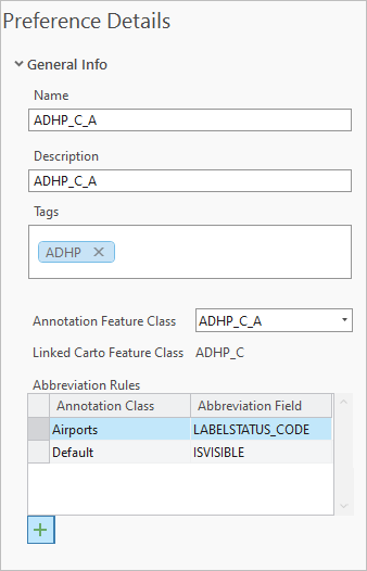

  2. Click the new record.
  3. Go to the Preference Details pane and expand the General Info section.
  4. In the Name text box, type a unique name that defines the preference you are creating.
    Hinweis:
    You cannot have multiple preferences of the same type with the same name. For example, you can have two separate preferences called Airspace Route for the Process ATS Routes and Generate Airspace Lines tools. You cannot, however, have two preferences called Airspace Routes for the Generate Airspace Lines tool.
  5. In the Description text box, type a unique description for the preference.
  6. In the Tags text box, type descriptive tags for the preference.
  7. Continue configuring the preference you chose in the appropriate section below:

Configure preferences for the Abbreviate Annotation command
To configure annotation abbreviation preferences in a preferences table using the Abbreviate Annotation command , complete the steps below. The Abbreviate Annotation preference determines how the Annotation tool's Aviation Abbreviate command can update the labeling on feature-linked annotation features.
Hinweis:
Before you can configure abbreviation rules, the database must contain feature-linked annotation feature classes. Those annotation feature classes must have at least one annotation class defined, which is made available in the Annotation Class drop-down menu in the Preference Details pane. The associated linked feature class must contain at least one coded value domain field, which is made available as an Abbreviation Field option in the preference.
  1. Click the Annotation Feature Class drop-down arrow and select the annotation feature class in the database that needs abbreviation rules.
  2. Click Add at the bottom of the pane to add an entry.
    Preference Details pane with the Add button highlighted
  3. For each entry in the Abbreviation Rules table, click the Annotation Class column drop-down arrow and choose an annotation class; then click the Abbreviation Field column drop-down arrow and choose an abbreviation field.
  4. On the Preferences tab, in the Preferences group, click Save.
    Your changes have been committed, and the preference table in the Aviation Charting AIS geodatabase has been populated.
Only one preference per annotation feature class can be defined. The preference’s Name value is automatically set to the name of the selected annotation feature class, and the Name text box is unavailable.
Hinweis:
Each preference can contain abbreviation rules entries that can associate multiple annotation class names to abbreviation fields; however, an annotation class name can only be defined one time in the Abbreviation Rules table.
