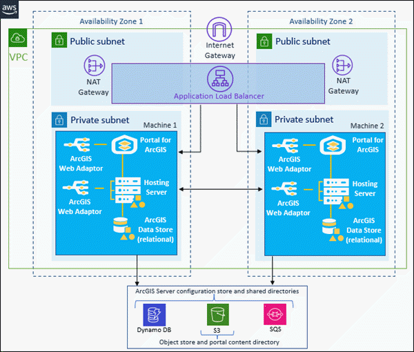

This template can create the following architecture in Amazon Web Services:
This template creates one of the following architectures in AWS, depending on which value you choose for the Configuration Store Type parameter.
If you specify CloudStore for the Configuration Store Type parameter value, you get the following architecture:
An ArcGIS Enterprise deployment with components on a primary EC2 instance and a standby EC2 instance, and the configuration store, server directories, portal content directory, and object store in cloud services

If you specify FileServer for the Configuration Store Type parameter value, you still get an S3 bucket for the object store, but the file server shown above also contains the configuration store, shared directories, and content directory.
You must create the Amazon Virtual Private Cloud (VPC), subnets, and load balancer before running this template.
