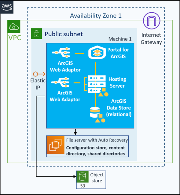

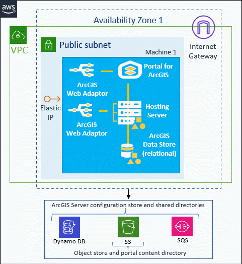

This template can create the following architecture in Amazon Web Services:
This template creates one of the following architectures in AWS, depending on which value you choose for the Configuration Store Type parameter.
If you specify CloudStore for the Configuration Store Type parameter value, you get the following architecture:
If you specify FileServer for the Configuration Store Type parameter value, you get the following architecture:
