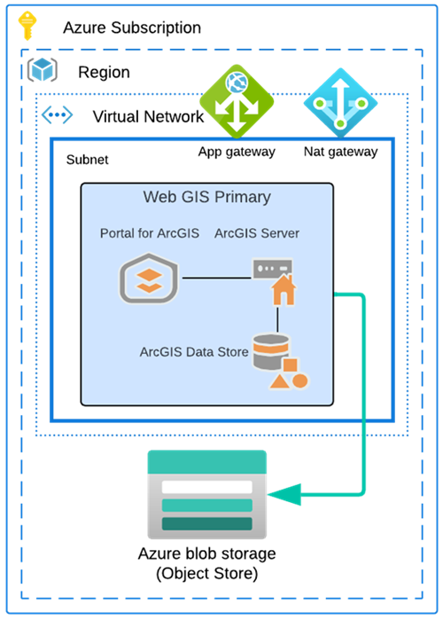

When you use the single-tier option, you can include one virtual machine or two. The following diagram shows a single-tier ArcGIS Enterprise deployment on one virtual machine using the file server option:
Single-tier base ArcGIS Enterprise deployment on one virtual machine in Azure created using Cloud Builder

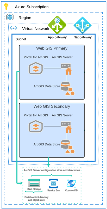

If you include two virtual machines in a single-tier ArcGIS Enterprise deployment, both machines run Portal for ArcGIS, ArcGIS GIS Server, and ArcGIS Data Store configured as the relational store. This is shown in the following diagram:
Single-tier base ArcGIS Enterprise deployment on two virtual machines in Azure for high availability

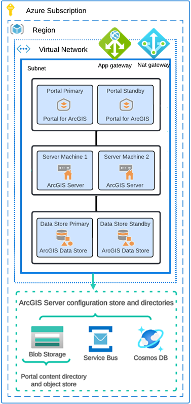

When you create a multitier ArcGIS Enterprise deployment, the different parts of the base deployment are installed on separate machines. This distributes resources and allows you to specify up to two machines for Portal for ArcGIS, up to two machines for the relational ArcGIS Data Store, and multiple machines for the hosting server site.
In the following diagram, there are two Portal for ArcGIS machines, two machines in the hosting server site, and two machines in the relational store. The portal content directory, the hosting server's configuration store, and the object store are in Azure cloud service storage.
Multitier ArcGIS Enterprise deployment on Azure created using Cloud Builder

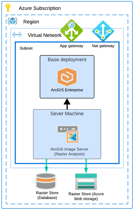

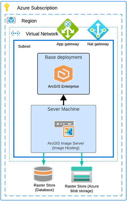

Image hosting and raster analysis server sites
When you include a federated ArcGIS Image Server site with the ArcGIS Enterprise deployment, it can serve the role of the deployment's image hosting server. It can also fill the role of the ArcGIS Enterprise deployment's raster analysis server, which allows organization members to run raster analysis tools and functions to analyze imagery data.
In both cases, the site must have a registered database and a raster store. In the exmample below, a registered database (enterprise geodatabase) and Azure Blob Storage container are incluced.
Federated ArcGIS Image Server site on Azure in the role of image hosting server or raster analysis

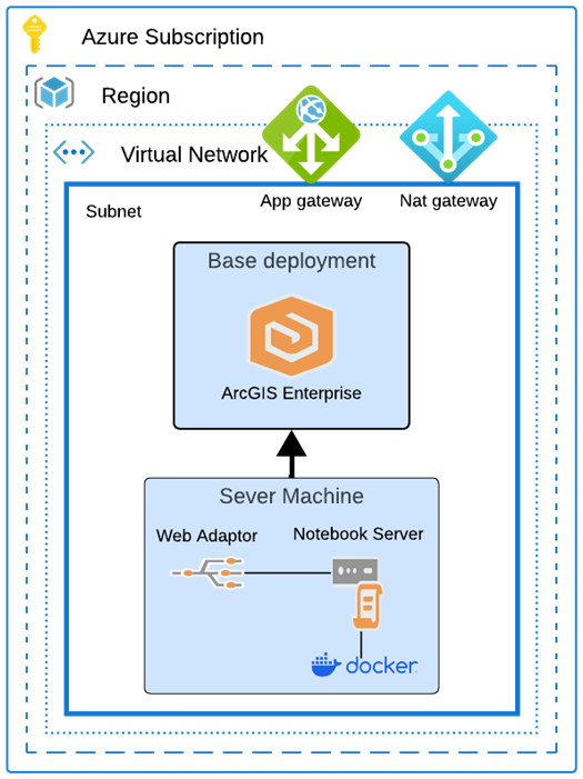

ArcGIS Notebook Server site
You can include an ArcGIS Notebook Server site with an ArcGIS Enterprise deployment. Notebook Server sites are always federated and configured for the Notebook Server role.
ArcGIS Notebook Server is deployed in a Docker container and uses ArcGIS Web Adaptor (IIS) for communication when you create the deployment using Cloud Builder.
Federated ArcGIS Notebook Server site in Azure

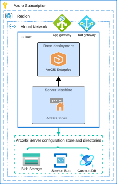

The following diagram shows a federated GIS Server site created using Cloud Builder:
A federated GIS Server site in Azure

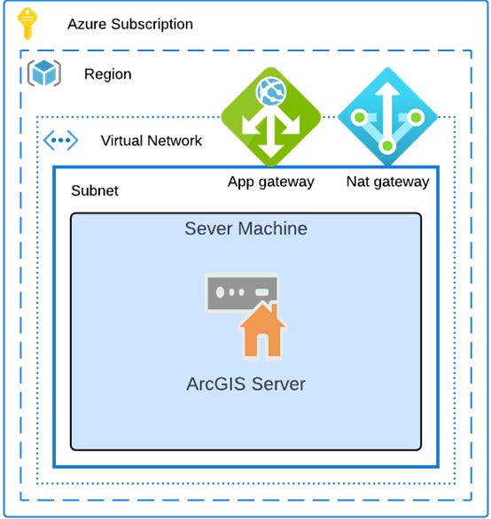

When you create a stand-alone ArcGIS GIS Server site on Azure using Cloud Builder, you specify the number of virtual machines in the site. If the site includes a single machine, the configuration store and ArcGIS Server directories can be stored on the same machine as ArcGIS Server. A single-machine GIS Server site created using ArcGIS Enterprise Cloud Builder for Microsoft Azure is shown below.
ArcGIS Server on a single virtual machine in Azure

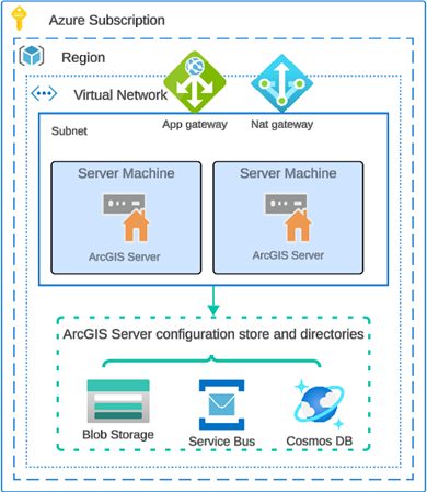

If you create a stand-alone GIS Server site that contains multiple machines, you can store the configuration store and ArcGIS Server directories in Azure cloud services. In the following diagram, a file server virtual machine is used for both the configuration store and shared directories:
An ArcGIS Server running on two virtual machines in Azure plus a third virtual machine for the ArcGIS Server configuration store and directories

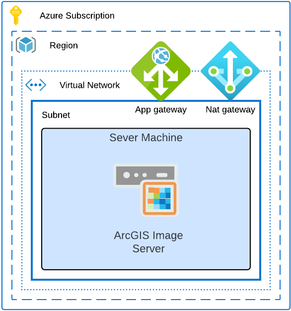

Stand-alone ArcGIS Image Server site
You can create a stand-alone ArcGIS Image Server site using Cloud Builder. If the site includes a single machine, the configuration store and ArcGIS Image Server directories can be stored on the same machine as ArcGIS Image Server.
A stand-alone ArcGIS Image Server site on Azure

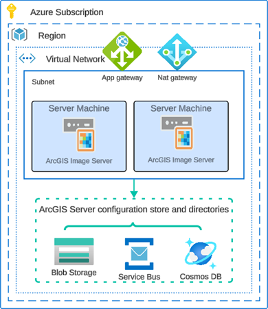

When you create a multiple-machine stand-alone ArcGIS Image Server site using Cloud Builder, the configuration store and ArcGIS Server directories can be stored in Azure cloud services.The following diagram shows a two-machine ArcGIS Image Server site:
A stand-alone ArcGIS Image Server site containing two machines, plus a third machine for the configuration store and shared directories on Azure

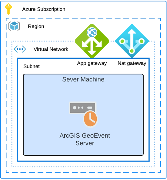

Stand-alone ArcGIS GeoEvent Server site
ArcGIS GeoEvent Server sites are always on a single virtual machine when created using Cloud Builder. The configuration store and directories are stored on the same machine as ArcGIS GeoEvent Server, as shown in the diagram below.
A stand-alone ArcGIS GeoEvent Server site on Azure
