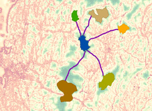

Map of paths for each destination back to the source
The Each zone option was selected. The least-cost paths (purple lines) from each destination back to the cheapest source are identified. The cost surface is displayed in the background.

Many paths will converge into a single path when the Create network paths parameter is checked.
Map of many paths converging into a single path when Create network paths is checked
When the Create network paths parameter is checked, paths are considered to overlap when they move through the same cell. At that point, all incoming paths to a cell are terminated and a single outgoing path is initiated. Each separate edge is emitted as a polyline feature, along with its change in accumulative cost. The group of paths to the right side of the image are now grouped into one path (the thicker brown line).
