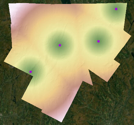

Determining how far away one thing is from another is the basic element of calculating distance. It is the straight-line or Euclidean distance between two points. For additional information, see Calculate straight-line distance.
However, there are other factors that can alter the straight-line distance calculation including barriers and surface distance.
A barrier, such as a river, cliff, highway, or building, is something that prevents you from traveling directly from one location to another. Since detouring around the barrier means it will be farther to travel, you may want to know the shortest possible distance. For use cases and additional information, see Account for barriers in distance calculations.
The surface distance is the actual distance on the ground that must be traveled when moving over the landscape. Compared to the straight-line distance, the surface distance is farther when accounting for the up and down undulations of the actual ground surface. For use cases and additional information, see Account for surface in distance calculations.

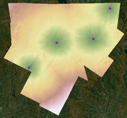

For each cell, a cost surface identifies how the features at the location affect the movement through the cell. It is the cost to the traveler to move through the location. The lower the defined cost for a cell, the easier the movement. For example, a hiker can move quickly and easily through an open field, but muddy ground in a thick forest will slow them down, making them use more energy and it will take longer to travel each distance unit. For use cases and additional information about how the cost surface affects how distances are encountered, see Adjust the encountered distance using a cost surface.
The distance is measured as a rate of cost. Because of the cost surface, the cost distances do not radiate equally from each source as they do in the straight-line distance result.
