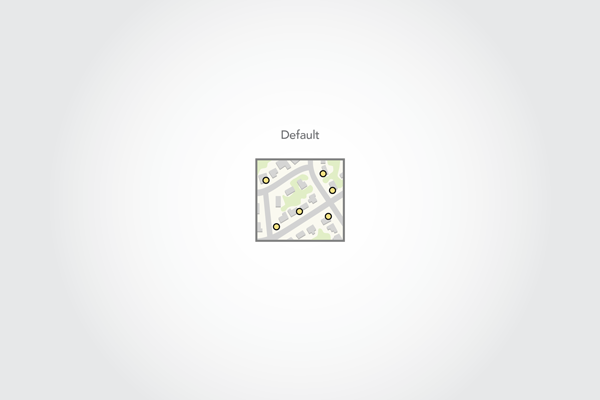

The publisher starts ArcGIS Pro and adds data from the default version to a map. In this example, the data includes new sensors from a feature class in the company's enterprise geodatabase. The feature class is registered as versioned.
Default version
The publisher publishes a feature layer named NetFS that references registered data from ArcGIS Pro.
Feature service published from the default version

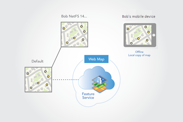

With the web map available to them, workers can download it to an app on their mobile device, and go into the field to inspect requested updates. To do this, a worker named Bob starts the app on his mobile device while connected to the network, signs in to the organization, and downloads the web map to his device.
Connect to the map from mobile device to download it.
When the download process starts, a replica version named Bob_NetFS_1404578882000 is created from the published version (default) in the backend geodatabase. Because the service was set to create a version for each downloaded map, a unique version name is generated. The name is composed of the mobile worker's login (Bob), the feature service name (NetFS), and a unique ID. This replica version will be used when the downloaded map is synchronized.
Replica version created when the map is downloaded
The data is then downloaded to the device and the app switches the map to reference the local data. At this point, the map can be edited without being on the network.

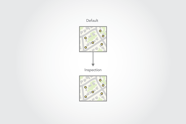

To organize the work, the project manager creates a version from the default geodatabase version. The manager names the child version Inspection and changes the map to reference this version.
Create the Inspection version from the default version.

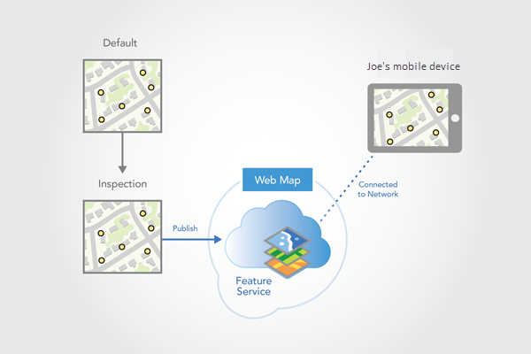

In the following diagram, one of the mobile workers (Joe) starts the download process.
Connect from mobile app to download the map.
Joe chooses the extent and the base map resolution for the map.
When the download process starts, a replica version is created from the published version in the source geodatabase called Joe_InspectionFS. Because the feature service was set to create a version for each user, the replica version name is based on the mobile worker's login (Joe) and the name of the service from which it was created (InspectionFS). This replica version will be used when the downloaded map is synchronized.

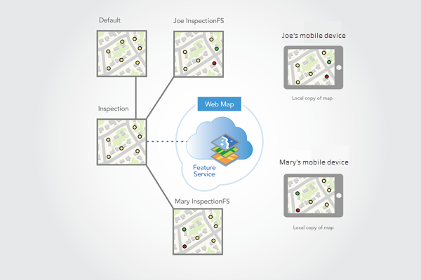

A second mobile worker (Mary) performs the same steps as Joe. This results in a Mary_InspectionFS replica version being created in the source geodatabase.
Second replica version created when another client downloads the web map

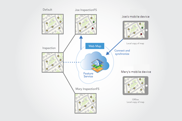

While in the field, Joe is assigned work on the east side of the map. Joe updates sensor feature statuses while performing inspections. If the sensor passes inspection, it appears green. If it is damaged and requires repair, it appears red.
At the end of the day, Joe connects to the network from the field device and synchronizes with the feature service. This applies the edits to the Joe_InspectionFS replica version in the source geodatabase.
Joe connects and synchronizes edits.
