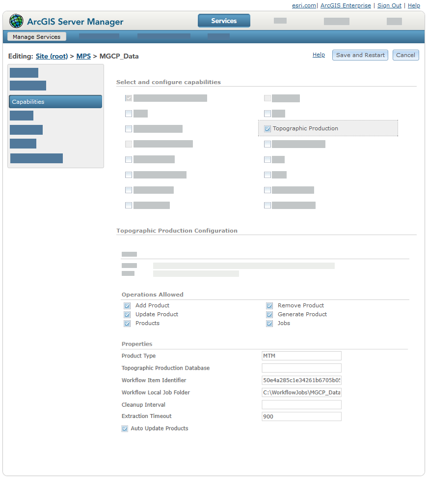

Configuration in ArcGIS Server
You can configure the operations that the service can perform and other properties in ArcGIS Server Manager after the service is published. These settings appear when you check the Topographic Production check box or click Topographic Production, and are only applied if the check box is checked..
ArcGIS Server Manager with the Topographic Production capability highlighted to show its operations and other properties that were set when the service was published from ArcGIS Pro
