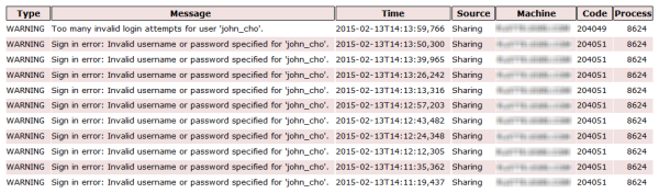

Some messages are returned along with additional information. For example, you'll see the following messages if a user enters the incorrect password too many times and is locked out of their account:
Log Messages page in ArcGIS Portal Administrator Directory
In the above scenario, the user john_cho was attempting to sign in but was entering the wrong password. After five attempts, the account lockout policy was enforced and the user was locked out of the account. This may also indicate a malicious user is attempting to access the organization.
All events record the above information, such as the log level type, the time at which the event occurred, the source component that logged it, the machine on which the event occurred, the user associated with the event, the log code, the process ID, and the request ID. All of this information can help you troubleshoot your organization more effectively. See Understand logs for a detailed explanation of this information.
