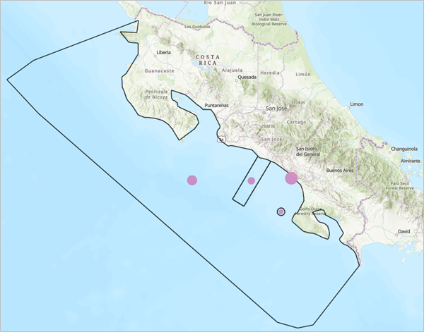

A GIS analyst is studying whale populations in marine protected areas in Costa Rica. The analyst uses Aggregate Points to determine which protected area had the most whale sightings in the four-month study period.
Summarize whale sightings within marine protected areas.
