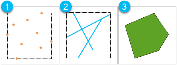

  • Extent layer specifies the point, line, or polygon features that define the extent of the features to be extracted. You can choose a layer by clicking Layer Layer , or you can create a sketch layer to use as the input using the Draw input features button.
    When using a point layer or line layer as the extent layer, the extent of the extracted features will be defined by the full extent of the chosen layer, rather than by individual features. When using a polygon layer as the extent layer, the input features will be extracted if they intersect with the polygon features in the extent layer.
    The numbers in the following image correspond to the numbers in the table below.
    Comparison of extent layers for points, lines, and polygons
    Label Description
    1 Point layer—The extent is based on the extent of the layer.
    2 Line layer—The extent is based on the extent of the layer.
    3 Polygon layer—The extent is based on the shape of the polygons.

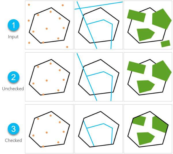

  • Clip features that intersect the extent specifies whether features that intersect the extent layer will be clipped. This parameter is available when an input layer is selected for Extent layer. The parameter options are as follows:
    • Unchecked—Features that intersect the extent layer will be extracted without clipping.
    • Checked—Features that intersect the extent layer will be clipped, and only portions of those features within the extent layer will be extracted.
      Comparison of input layers and outputs when the clip setting is unchecked or checked
      Label Description
      1 The input point, line, and polygon layers, and extent layer.
      2 The output point, line, and polygon layers when Clip features that intersect the extent is unchecked.
      3 The output point, line, and polygon layers when Clip features that intersect the extent is checked.
