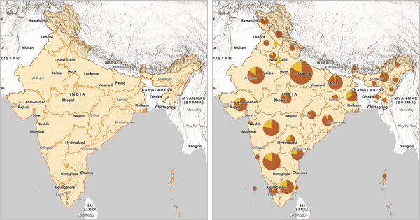

You have data stored in a table that you need to display spatially. The table counts the number of Primary Health Centers (PHCs) in each state or union territory in India. The Join Features tool can be used to join the table to a feature layer so the PHC data can be shown spatially.
Join PHCs to state and union boundaries
The first image shows the input feature layer (India state and union territories). The second image shows pie charts indicating the number of rural and urban PHCs per boundary.

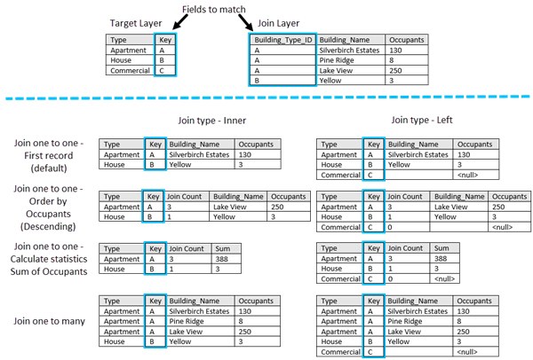

Example of inner and left joins
This example shows one-to-one and one-to-many attribute joins using inner and left join types. In this example, the one-to-one joins include the default record, the sum of Occupants, and the maximum from Occupants.
