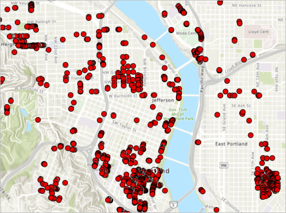

    Scene with 2D points representing trees
    The tree layer is added to the scene as 2D points. Scene Viewer automatically zooms to the extent of the layer.

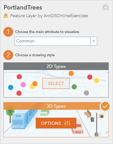

  2. Click the Portland Trees layer to change layer style.
  3. For Choose the main attribute to visualize, choose Common to style your trees by the common tree type name.
    Note:
    If you choose a numeric attribute from the list, you can style the trees more thematically with the 3D Counts and Amounts style that uses proportional symbols and color.
  4. For Choose a drawing style, click Select to change the selected style to 3D Types and apply it to the scene.
    Layer style pane with the main attribute set to Common and the drawing style set to 3D Types

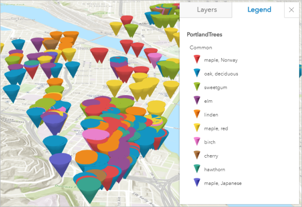

  5. Toggle on the rotate tool by clicking the rotate button in the scene.
  6. Zoom in and rotate the scene to observe your changes.
    Scene and legend with 3D cones representing tree types
    The 2D circles changed to default 3D cones representing Portland's trees. These are 3D object symbols with real-world dimensions.

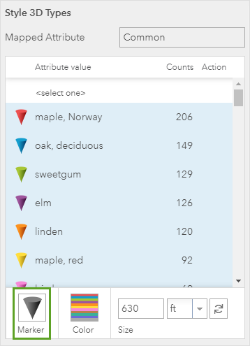

  1. Click Options to open and modify the 3D Types style.
  2. Click Select all at the top of the list of common tree types.
    For the purposes of this lesson, you'll apply a single tree style to all the common tree types. With the 3D Types style, you can give each tree type a unique tree style, if you have time.
  3. Click Marker.
    Style 3D Types section with all tree types selected and a green square around the Marker button

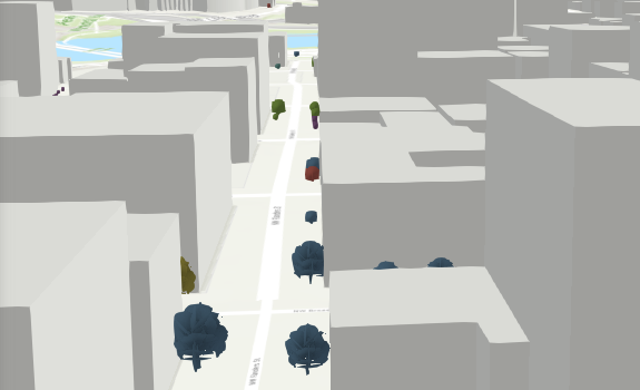

  4. Navigate around the scene. Zoom out some so you can see more trees and buildings in the city.
    Buildings added to scene

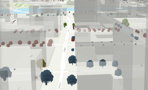

    With the buildings added, you may notice that it is more difficult to see the trees among the buildings. You'll set a transparency on the buildings so the trees are more visible and easier for your audience to identify.
  5. To set transparency in the Portland Buildings layer, click the layer options button and choose Layers properties.
  6. Under Transparency, set the transparency to 50 percent so you can see the trees.
    Scene updated with transparent buildings
