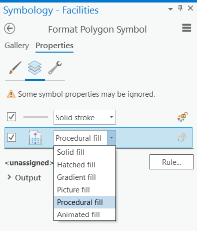

  5. Configure the symbology for the 3D layers.
    Optionally, enable edge rendering for the Details 3D and Facilities 3D layers by choosing White (use textures) with Edges for the layer in the Symbology pane.

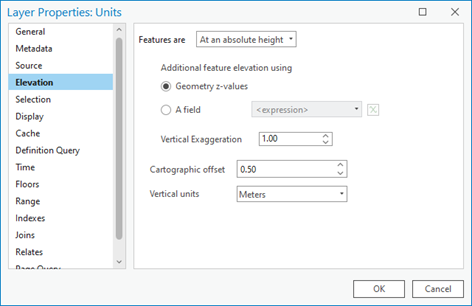

Prepare units for 3D
To prepare units for a 3D scene, complete the following steps:
  1. In the Contents pane, right-click the Units layer and click Properties.
    The Layer Properties dialog box appears.
  2. On the Elevation tab, set the Features are parameter to At an absolute height.
  3. Set the Additional feature elevation using parameter to Geometry z-values.
  4. Set the Cartographic offset parameter to 0.50 and set the Vertical units parameter to Meters.
    Configure the elevation of features on the Layer Properties dialog box.

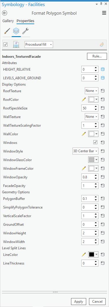

Convert a facilities polygon to a 3D facade
To convert a facility polygon to a 3D textured facade, complete the following steps:
  1. Right-click the Facilities layer and click Properties.
  3. Set the Additional feature elevation using parameter to the Geometry z-values option.
  4. Set the Cartographic offset parameter to 0.50 meters, and click OK.
  5. Click the symbol for the Facilities layer in the Contents pane to open the Symbology pane.
    The Format Polygon Symbol pane appears.
  6. Click the Properties tab.
  7. Click Layers and choose Procedural fill.
    Stroke and fill settings on the Properties tab of the Format Polygon Symbol pane
  8. Click Rule to assign a procedural rule package (*.rpk) and choose the Indoors_TexturedFacade.rpk file in the Symbology folder that is included in the Indoors product data files.
    Note:
    You can use your own rule package or textured multipatch building models for a more customized look and feel. The provided sample rule package uses the Relative Height and Levels Above Ground attributes to create a simple 3D textured facade, split by floor.
    The procedural fill parameters appear. Hover over each parameter for information about how the value changes the look of the finished building facade.
    In the Attributes section in the Format Polygon Symbol pane, the HEIGHT_RELATIVE and LEVELS_ABOVE_GROUND attributes are read directly from the Facilities polygon, as indicated by the database connection symbols and shown in the following image:
    Attributes section of the Format Polygon Symbol pane
    The Display Options section allows you to customize the roof, wall, and window styles and textures.
  9. Click Apply after each Procedural fill parameter change to show the result in the scene.
  10. In the Geometry Options section, use the options to simplify the polygon, buffer it slightly, or alter the window size.
  11. Click Apply to create the final 3D textured facade model.
