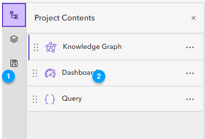

Click Project Contents
in the main menu (number 1 in the image above) to open the Project Contents pane (number 2 in the image above).
