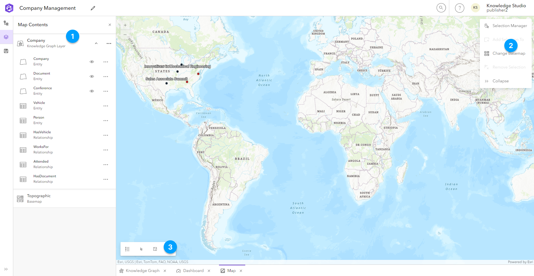

Add a knowledge graph to a map
You can add entities with a spatial location to a map. This allows you to visualize spatial relationships between entities that are not apparent in a nongeographic view.
When you add entities and relationships to a map, a knowledge graph layer is created in the Map Contents pane (number 1 in the image below). A knowledge graph layer is a composite layer with a knowledge graph as its data source. The knowledge graph layer contains knowledge graph feature sublayers and knowledge graph table sublayers. Knowledge graph feature sublayers provide access to entity and relationship types in which their instances can have spatial features. Knowledge graph table sublayers provide access to nonspatial entity and relationship types.
Map view diagram
You can create a blank map in the Project Contents pane or you can start from any of the views in which you work with a knowledge graph: link charts, the knowledge graph view, data cards, global search, query results, selection manager, and other maps. You can select entities and relationships in the active view and add them to a new map. After adding content from a knowledge graph to a map, use the context toolbar (number 2 in the image above) to work with graph layers in much the same way you work with feature layers and stand-alone tables.
Open a feature sublayer's attribute table to see the properties of entities that can have spatial features. Open a table sublayer in the knowledge graph layer to see the properties of nonspatial entities and relationships.
You can also import maps from your portal to use in your project.
