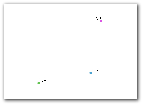

Reading point geometries
The examples below use SearchCursor to print the coordinates for all features.
Search cursor on a point feature class
import arcpy
infc = arcpy.GetParameterAsText(0)
# Enter for loop for each feature
for row in arcpy.da.SearchCursor(infc, ["SHAPE@XY"]):
    # Print x,y coordinates of each point feature
    x, y = row[0]
    print("{}, {}".format(x, y))
Point geometry
With the above feature class, the script returns the following information:
2.0 4.0
8.0 10.0
7.0 5.0

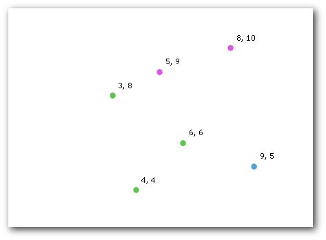

Reading multipoint geometries
Search cursor on a multipoint feature class
import arcpy
for row in arcpy.da.SearchCursor(infc, ["OID@", "SHAPE@"]):
    # Print the current multipoint's ID
    print("Feature {}:".format(row[0]))
    # For each point in the multipoint feature,
    #  print the x,y coordinates
    for pnt in row[1]:
        print("{}, {}".format(pnt.X, pnt.Y))
Multipoint geometry
With the feature class above, the script returns the following information:
Feature 0:
3.0 8.0
4.0 4.0
6.0 6.0
Feature 1:
5.0 9.0
8.0 10.0
Feature 2:
9.0 5.0

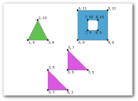

Reading polyline or polygon geometries
Search cursor on a polygon or line feature class
import arcpy
    # Print the current polygon or polyline's ID
    partnum = 0
    # Step through each part of the feature
    for part in row[1]:
        # Print the part number
        print("Part {}:".format(partnum))
        # Step through each vertex in the feature
        for pnt in part:
            if pnt:
                # Print x,y coordinates of current point
            else:
                # If pnt is None, this represents an interior ring
                print("Interior Ring:")
        partnum += 1
Polygon geometry
With the feature class above, the script returns the information below. Feature 0 is a single-part polygon, feature 1 is a two-part polygon, and feature 2 is a single-part polygon with an interior ring.
Feature 0:
Part 0:
3.0 8.0
1.0 8.0
2.0 10.0
3.0 8.0
Feature 1:
Part 0:
5.0 3.0
3.0 3.0
3.0 5.0
5.0 3.0
Part 1:
7.0 5.0
5.0 5.0
5.0 7.0
7.0 5.0
Feature 2:
Part 0:
9.0 11.0
9.0 8.0
6.0 8.0
6.0 11.0
9.0 11.0
Interior Ring:
7.0 10.0
7.0 9.0
8.0 9.0
8.0 10.0
7.0 10.0
