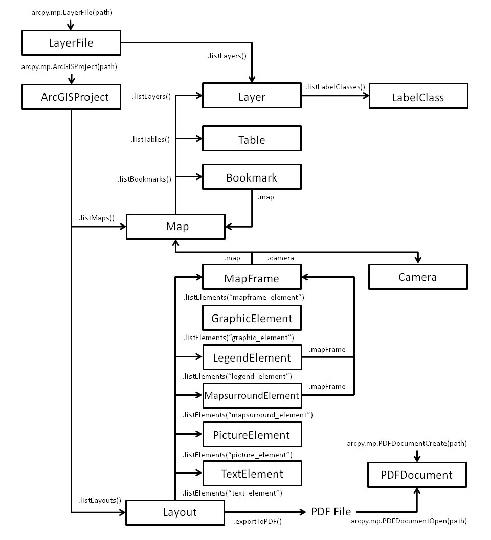

The following diagram displays some of the most common classes that are part of arcpy.mp and the location and name of the functions or properties needed to reference a particular class. The diagram is only an example and does not display a complete set of objects. The two main entry points to the objects are either through the ArcGISProject class or the LayerFile class.
arcpy.mp OMD overview
