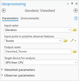

If you open a tool without the appropriate extension, it will display an error message.
Tip:
If an extension license is required to run a geoprocessing tool, this requirement is shown at the top of the tool's help topic. Licensing requirements are also found in the toolbox licensing help topics. For example, see Viewshed and Spatial Analyst toolbox licensing.

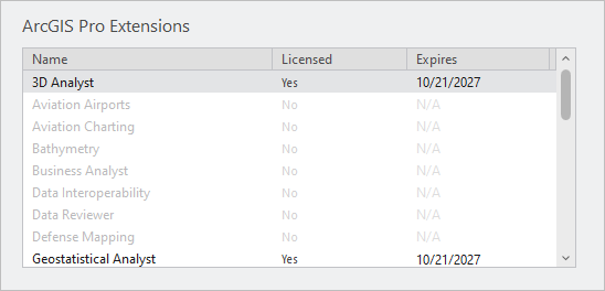

View extension licenses
You can see which extensions you are licensed to use on the ArcGIS Pro Settings page.
From an open project, click the Project tab on the ribbon. Alternatively, from the ArcGIS Pro start page, click the Settings tab
.In the list of side tabs, click Licensing.
On the Licensing page, under ArcGIS Pro Extensions, all Esri extensions are listed.
In this example, the user is licensed to use the 3D Analyst and Geostatistical Analyst extensions. In the Licensed column, a Yes or No value indicates whether the extension is licensed for use.
In the Expires column, the value N/A means your organization does not have licenses for the extension. An expiration date of Never means you are assigned a perpetual license. A specific expiration date means you are assigned a subscription-based license.
