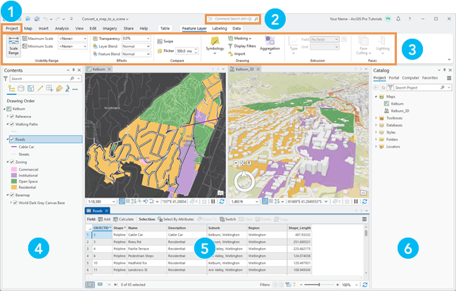

The numbers in the following image correspond to the numbers in the table below it:
ArcGIS Pro user interface
The ArcGIS Pro user interface includes a ribbon, views, and panes.
Component
Description
How this compares to ArcMap
1 Project tab
Provides access to application settings and other configurable properties.
This is comparable to the settings on the Customize menu: ArcMap Options, ArcCatalog Options, ArcGlobe Options, and ArcScene Options, respectively.
2 The Command Search box
Command Search helps you find and open geoprocessing tools and run user interface commands. You can also access help topics related to the search terms.
This is comparable to the Search window in ArcMap in that you can find and open geoprocessing tools.
3 The ribbon
Organizes commands on a series of tabs. A tab includes groups of related commands. For example, on the Map tab, the Navigate group has commands for zooming, panning, and setting the map extent.
These tabs are more context sensitive than the toolbars in ArcMap, and may change based on the state of the application.
4 Contents pane
Displays items related to the active view, which may be a map, a scene, a layout, or a view of the catalog.
This is similar to the way ArcMap displays the contents of a document in the table of contents.
5 Table view
Views—such as the map, scene, and table views in this example—are the primary work areas in ArcGIS Pro.
Views are comparable to the data and layout views in ArcMap and the 3D view in ArcGlobe and ArcScene.
6 Catalog pane
The items in a project can be managed in the Catalog pane.
This is similar to the Catalog window in ArcMap.
ArcGIS Pro user interface components
Learn more about the ArcGIS Pro user interface
Similar to creating and modifying toolbars in ArcMap, you can customize ribbon tabs, create custom tabs, and modify the Quick Access Toolbar in ArcGIS Pro.
