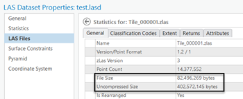

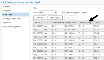

Check point spacing and file size
Examine the LAS file’s point spacing and file size in the LAS dataset’s properties.
LAS file size
LAS point spacing

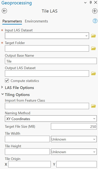

Use the Tile LAS geoprocessing tool
The Tile LAS geoprocessing tool.
In the Import from Feature Class parameter, you can define the tile schema using a polygon feature class. The tile width and height are determined by the x and y extent of the first (optionally selected) feature, while the tile origin is derived from the lower left corner of this feature’s extent. Instead of using common naming methods (for example, XY Coordinates), you have the option to name tiles based on each feature’s attribute, providing flexibility in naming.
Note:
You can use the Create Fishnet geoprocessing tool to create rectangle grids. Make sure the grid boundaries align with the x and y axis.

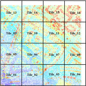

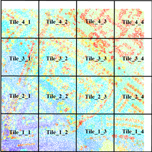

In the Naming Method parameter, there are three options available for the naming method:
  • XY Coordinates—The x and y coordinates of the lower left corner of each tile.
  • Rows and Columns—The row and column numbers of the entire tiling schema. Rows increment from bottom to top, and columns increment from left to right.
  • Ordinal Designation—Numbers increment from left to right and from bottom to top.
Rows and column naming Ordinal Designation naming
In the Target File Size (MB) parameter, the default value is 250 megabytes (uncompressed size). Upon entering a file size, the tool will estimate the corresponding tile width and height.
In the Tile Width/Height parameter, you have the flexibility to input custom values for tile width and height, and the tool will then estimate the target file size accordingly.
Note:
Adjusting the file size will automatically modify the tile width or height, and similarly, altering the width or height will update the file size accordingly.
In the Tile Origin parameter, by default, the tile origin is the lower left corner of the input LAS dataset’s extent. Alternatively, you can manually specify the tile origin as needed.

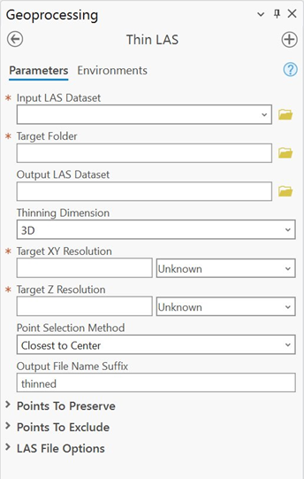

Use the Thin LAS geoprocessing tool
geoprocessing tool
The Thin LAS geoprocessing tool is shown.
In the Thinning Dimension parameter, the two options are 3D (default) and 2D.

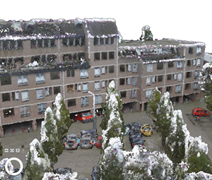

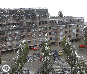

  • 3D—This option uses 3D grid cells to select points, retaining at most one or two points from each 3D grid cell (unless some points have been chosen to be preserved). As there are multiple 3D grid cells along the z dimension, multiple points with different z values can be selected along the z dimension, this allows the selection of points with different z values, maintaining the point clouds' vertical distributions. Choose 3D thinning to preserve vertical structures of features, such as building walls.
  • 2D—This option uses 2D grid cells for point selection, keeping at most one or two points from each 2D grid cell (unless some points have been chosen to be preserved) while removing others along the z dimension. It results in a evenly distributed point cloud with a consistent point density.
Not thinned point cloud Thinned point cloud
The Target XY/Z Resolution parameter controls the size of the 3D/2D grid, with a larger resolution resulting in a larger grid size. Choose a larger resolution to remove more points from your data, while choosing a smaller resolution if you intend to retain more details in your data.
The Point Selection Method parameter controls how to select the points from each grid cell, with a total of 11 methods that can be grouped into three categories:
  • Location-based method—Select points based on their locations within each grid cell. Choose the closest to center option for a regularly distributed point cloud. Choose the closest to the average height option to have the selected point represent the average height in each grid cell. Choose the lowest point, the highest point, or the lowest and highest point options, if you want the selected points to represent the extreme z values in each grid cell. If your interest is the feature’s top surface (for example, building roofs), the ground surface, or both, choose the highest point, the lowest point, or the lowest and highest points options together with 2D thinning.
  • Class code-based method —Select points based on their class codes within each grid cell. To use class code-based method, the point clouds must be pre-classified. Choose the most frequent class code to keep the predominant features in your data. For example, in a grid cell with a mix of sparse tree points and dense building roof points, it will select a building roof point. Another class code based approach is class code weights. Assign weights to each class code, and the method will select the point with the highest weight in the grid cell. This is useful when you have specific features of greater interest and wish to retain more points of those features. For example, if your point clouds include ground (class 2), trees (class 5), and buildings (class 6), and your priority is buildings, followed by trees, and then the ground. you can assign a weight of 3 to class 6, 2 to class 5, and 1 to class 2. In cases of mixed class codes within a grid cell, it will select the point with the highest assigned weight.
  • Intensity-based method—Select points based on their intensity values within each grid cell. It's important to note that the intensity-based method is applicable only to lidar point clouds, as photogrammetric point clouds lack intensity values. Choose the closet to average intensity option to retain the thinned data with the average intensity values of each grid cell. Alternatively, choose the lowest intensity, the highest intensity, or the lowest and highest intensity options if you want the thinned data to preserve the extreme intensity values in each grid cell. Certain features exhibit higher or lower intensity values compared to others, and using the intensity-based approach allows you to retain more points of these features during the thinning process. For example, in a point cloud, buildings generally have higher intensity values than trees. Using the highest intensity option, you can preserve more building points during the thinning process.
The Points To Preserve parameter can retain specific class codes, flags, or returns without thinning. This is particularly useful for preserving features with sparsely distributed objects, such as power lines. Ensure that these features have already been classified.
The Points To Exclude parameter can remove unwanted class codes, flags, or returns during the thinning process. For instance, exclude noise points (class 7 and class 18), overlap points (class 12 or overlap flag), and points flagged as withheld from your dataset.
