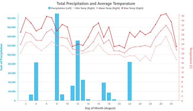

Create a combo chart to compare total daily precipitation with average, minimum, and maximum daily temperature during the month of August using the following settings:
  • X-axis—Date
  • Left y-axis:
    • Field name—Precipitation, Aggregation—Sum, Series type—Bar
  • Right y-axis:
    • Field name—Temperature, Aggregation—Mean, Series type—Line
    • Field name—Temperature, Aggregation—Minimum, Series type—Line
    • Field name—Temperature, Aggregation—Maximum, Series type—Line
Combo chart comparing total daily precipitation with average, minimum, and maximum daily temperature during the month of August
