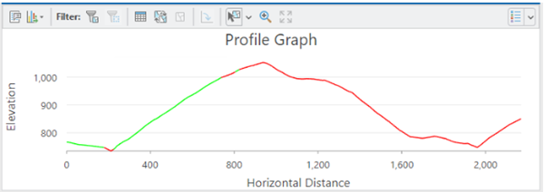

A profile graph can be used to display the result of the Line Of Sight geoprocessing tool; visible and invisible portions of the output lines will be arranged to make a continuous graph. If, before running the tool, you choose to output graphing attributes (additional point data) with the output lines, the profile graph can display observer, target, and obstruction points as well as connecting lines (from observer to target). The default is to output this information from the Line Of Sight geoprocessing tool.

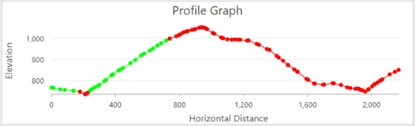

You can select an option from the Style drop-down menu: Line only, Line and vertices, or Fill.
The following is an example of the Line only option:
Line only profile graph

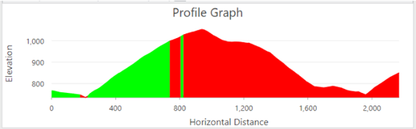

The following is an example of the Fill option:
Fill profile graph

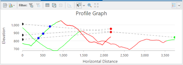

The following example of three pairs of visible and invisible lines results from the Line Of Sight tool output, with points and connecting lines displayed. In this case, two of the pairs are identical, so the lines give the impression of there being only two pairs.
Line Of Sight tool output Profile Graph example
Note:
Offsets were added at both the observer and target points so that the points are elevated in the graphic above. See Line Of Sight for more details.

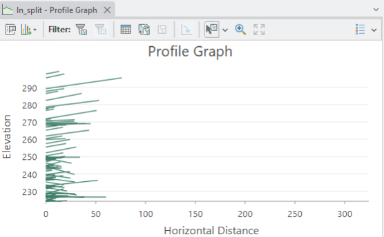

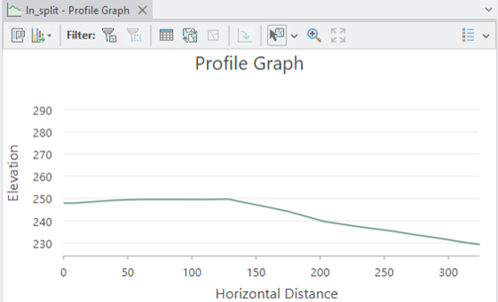

The following profile graph shows individual lines (before the Chain option is turned on):
Individual lines on a profile graph
The following profile graph shows a chained line (after the Chain option is turned on):
Chained line on a profile graph
Multipart lines should appear with gaps if there are gaps between parts. Cursor tracking should behave logically in multipart lines with gaps and in chains. Selection plays no role in chaining.

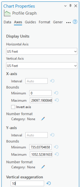

Profile graphs consist of continuous horizontal distance on the x-axis and either elevation (z) or measure (m) on the y-axis. The horizontal distance refers to the distance from the beginning of each 3D line when projected onto an imaginary horizontal plane, measured along the line. This applies whether or not all vertices are collinear in this horizontal projection. The automatic adjustment of visible and invisible lines that are output from the Line Of Sight tool, or the optional chaining of lines that are not from that output, will cause some or most lines to not appear to begin at zero on the x-axis.
Axes tab in the Chart Properties pane
The units of measure for the horizontal and vertical axes are displayed in drop-down menus on the  Axes tab in the Chart Properties pane. When a profile graph is created, its unit of measure is set to that of the dataset. If no unit of measure is assigned, the unit of measure will be meters (the default value). After a profile graph is created, you can select other units from the drop-down menus, and the profile graph and the axes will be redrawn accordingly.
Invert axis
The Invert axis option only impacts the x-axis (horizontal axis). When checked, the graph will be drawn from right to left rather than from left to right.
Vertical exaggeration
When a profile graph is created, it fills the chart window. When you resize the window, the profile graph is redrawn, which typically alters the apparent vertical exaggeration. You can edit the minimum and maximum bounds for either of, or both, the x-axis and y-axis. This also typically alters the apparent vertical exaggeration.
You can effect a vertical exaggeration by providing a value for the Vertical exaggeration option. To remove the value, click the Reset button next to the text box.
A value of 1 means that the vertical scale will be the same as the horizontal scale. Larger values exaggerate the vertical scale, for example, the graph will be taller or inflated in the vertical direction, and smaller values will shrink the vertical scale. Leaving this option blank, by clicking the Reset button, enables the charting system to automatically fit the y-axis values, and the y-axis scale will depend on the window shape and the values specified for axes minima and maxima, if any.
If a value is specified for this option, the graph will be centered vertically.

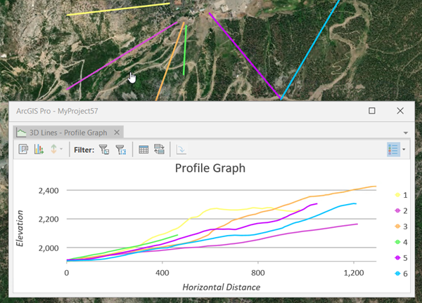

Example
The example below shows a profile graph that displays elevation change over the length of the input 3D lines.
  • X-axis—Horizontal distance
  • Y-axis—Elevation
Profile graph with six lines
