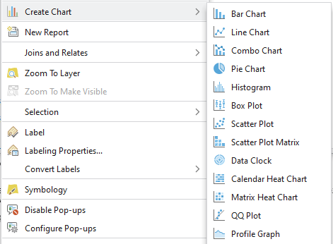

  4. On the layer's contextual Data tab, in the Visualize group, click the Create Chart button .
    Alternatively, right-click the layer in the Contents pane and point to Create Chart .
  5. Click Profile Graph .

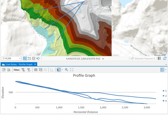

  9. Create a profile graph by doing the following:
    1. Select the new 3D lines using a selection tool . If you don't select any lines, then all of the lines in the layer will be depicted in the profile graph.
    2. Click the layer in the Contents pane.
    3. On the Data tab, in the Visualize group, click the Create Chart button .
      Alternatively, right-click the layer in the Contents pane and click Create Chart .
  10. Click Profile Graph in the list of charts.
A profile graph is drawn based on the selected lines in the newly created layer, or on all of the lines in the layer if there is no selection.
Profile graph

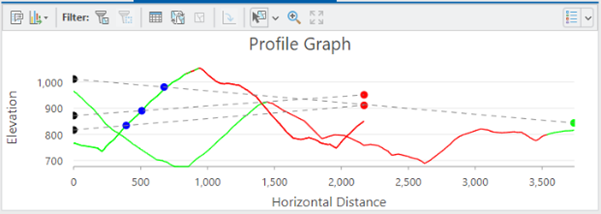

You can create profile graphs in ArcGIS Pro from output of the Line Of Sight tool. The following categories of elements can be displayed in a profile graph:
  • Visible and invisible lines starting from the observer point to the target point
  • An observer point, target point, and a possible obstruction point
  • A dashed line connecting the observer and target points
Profile graph with three element categories
