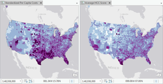

Below are two maps of United States counties showing information about Medicare beneficiaries in 2011. The first map shows variation in Medicare spending per capita. The second map shows variation in the overall health of the population. Through a visual comparison, you can get a sense of the relationship between the two variables by noting where the maps have similarities and differences.
By creating a scatter plot of the same variables, the relationship between Medicare spending and the health of the population is more clearly shown. The positive relationship between the two variables is shown by the upward slope of the trend line. The R2 value shows that the health of the population is roughly 41.5 percent of the variation in Medicare spending per capita.
