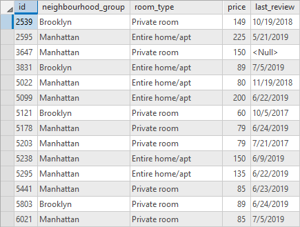

Consider a dataset with the following attribute table:
Sample attribute table

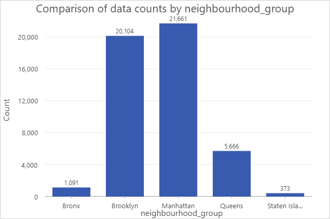

You can create a bar chart to investigate the distribution of the neighbourhood_group field categories, such as the following:
Bar chart illustration
When you export this chart to a table, the table summarizes the bar chart as follows:
Bar chart summary table
