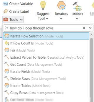

Use search in ModelBuilder
Access the search in ModelBuilder by typing ai: followed by the query text, using any of the following:
  • On the ModelBuilder tab, click the Tools drop-down arrow .
  • On the ModelBuilder toolbar, click the Tools drop-down arrow .
  • Start typing in the Model window to open the Add Tools To Model window.

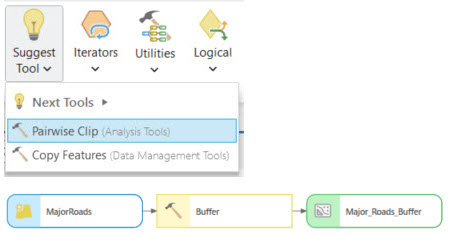

Tool suggestions are provided after adding the first tool to a model to help find the next step in a model workflow.
On the ModelBuilder ribbon, click the Suggest Tool button to provide suggestions using the existing tools in the model. This causes a prediction tracing back up to five tools in the model workflow.
Suggest Tool

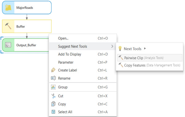

Alternatively, right-click the output of a tool and click Suggest Next Tools to view suggestions for tools to use for the next step.
Suggest Next Tools option

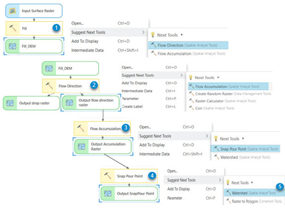

Example: Delineate a watershed using tool suggestions
A watershed is an area of land where water flows into a common stream or river. You can delineate a watershed from a digital elevation model (DEM) using a series of tools in the Hydrology toolset. Using the following steps, you will find that after adding the first tool in a model, the tool in the next step will be offered as a suggestion for you to use next.
  1. Use the Fill tool to remove any sinks in the DEM.
  2. Use the Flow Direction tool to calculate the direction water flows across land.
  3. Use the Flow Accumulation tool to calculate the number of cells that drain into another cell.
  4. Use the Snap Pour Point tool to create a pour point and snap it to the nearest cell with a high flow accumulation value.
  5. Use the Watershed tool to delineate the watershed.
Model workflow example

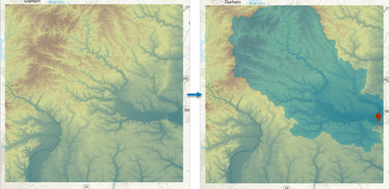

By following the tool suggestions in the model, you'll find that you can complete this analysis workflow in less time. An example of the output from this model is below.
Model workflow output
