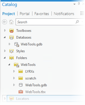

The following example is based on this project folder structure:
Example project

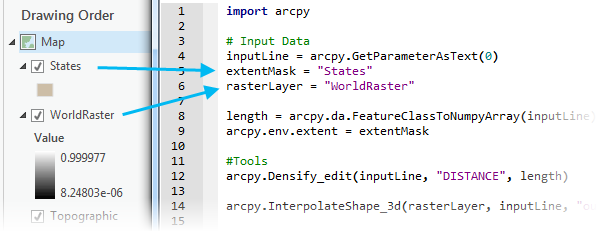

Reference layers as project data
A less common workflow of using layers as project data can result in significant performance improvements for a Python script tool. The Python code above uses full paths to feature classes and layer files. When a web tool is run, it must first open the dataset, and opening a dataset has a performance cost. Using layers in a script will keep the data opened and cached for faster implementation. The following image shows how layers in the project's contents are matched and used in the Python script:
Layers used in Python script tool
The variables (extentMask and rasterLayer) point to simple strings that match the layer names in the map. The data will be consolidated and available in the web tool when shared to your portal (if it's not referenced in the data store) and will hold a reference to the layers in memory. This name matching from the layers in the map to the strings in a script allows tools to work with layers.
