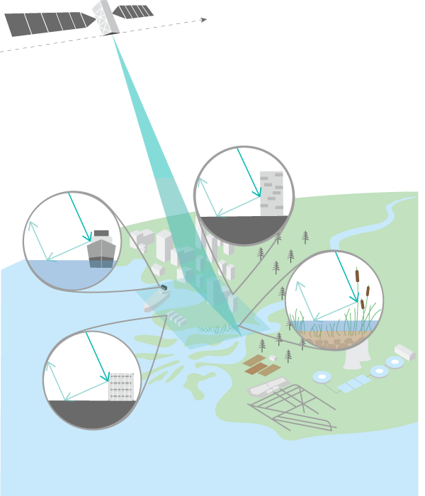

In double-bounce scattering, the radar signal reflects once off a vertical target onto a smooth surface and reflects a second time off the smooth surface back toward the sensor. For this scattering path, the polarization is not altered and causes a high backscatter in the copolarized band and a low backscatter in the cross-polarized band.
Double-bounce backscatter
Double-bounce backscatter for a ship (upper left), an urban structure (upper right), a shipping container (lower left), and flooded vegetation (lower right) is shown.

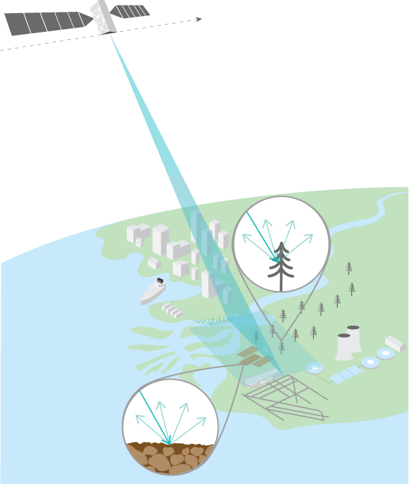

In volume scattering, the radar signal reflects off a 3D feature multiple times, changing polarization randomly during the reflections. Volume scattering can take place within canopies of short or sparse vegetation such as bushes, shrubs, or agricultural crops.
Volume and diffuse scattering
Volume scatter for trees, mature shrubs, and urban structure is shown in the upper right. Diffuse scattering for rough surfaces is shown in the lower left.
In diffuse scattering, the radar signal reflects once off a rough surface and is scattered in various directions. The rougher the surface, the higher the copolarized backscatter.

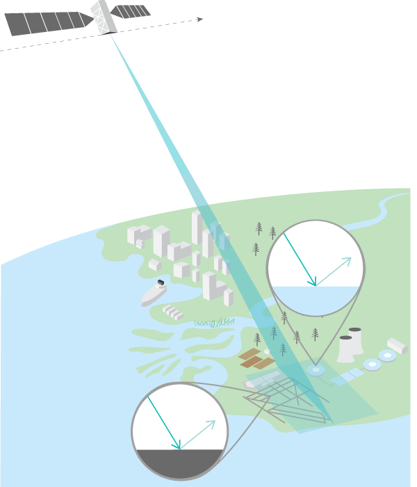

In single-bounce scattering, also known as specular reflection or forward scattering, the radar signal reflects once off a smooth surface, reflecting in a perpendicular direction relative to the original signal.
Single-bounce scattering
Single-bounce scattering for smooth surfaces such as roads and tarmacs (lower left) and water surfaces (upper right) is shown.

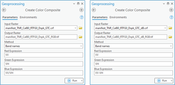

The Create Color Composite tool allows you to create a false color image by allowing you to define the bands for RGB. You can use band algebra expressions for each of the band expression parameters. To define the band math using the names of the bands, select Band names for the Method parameter. The band math used will depend on the units of your input SAR RTC data. If your input SAR RTC is in linear units, use VV for red, VH for green, and VV/VH for blue. If your input SAR RTC is in decibels (dB), the band combination should be VV for red, VH for green, and VV-VH for blue.
The dialog box on the left shows the parameters for data in linear units. The dialog box on the right shows the parameters for data in dB.

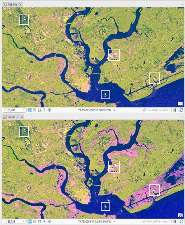

Below are examples of pre- and post-hurricane color composites using R: VV, G: VH, B: VV-VH in units of decibels. The color composites show water bodies including the ocean and rivers in blue, urban structures in yellow, vegetated and forested regions in greens, and flooded vegetation in the wetlands in pink. There are also some optimally oriented urban structures in pink.

Before and after hurricane
The top image is the pre-hurricane color composite. The bottom image is the post-hurricane color composite. Areas of interest (AOI) are outlined in white boxes.
Interpretation of the areas of interest
The four areas of interest (AOI) that will be interpreted are described in the following table:
AOI
Interpretation
AOI 1
The green pixels correspond to diffused scattering from grass. The blue pixels correspond to single-bounce scattering from a smooth airport tarmac and runways. The backscatter for this region does not change for the pre- and post-hurricane color composite. The consistent backscatter means the area was not flooded in the post-hurricane image.
AOI 2
The yellow pixels adjacent to the blue pixels correspond to double-bounce scattering and volume scattering from ships in port. The yellow and white pixels correspond to double-bounce scattering and volume scattering from shipping containers oriented orthogonally to the radar look direction.
The pink pixels in the pre-hurricane image correspond to double-bounce scattering from urban structures in the port that are oriented orthogonally to the radar look direction. These pixels are pink instead of yellow because little volume scattering occurs due to the structures being sparsely spaced.
The new pink pixels observed in the post-hurricane image are flooded vegetation. These newly flooded pixels are observed in the north along the coast and in the south along the riverbanks .
AOI 3
The blue pixels correspond to single-bounce scattering from permanent water bodies. The backscatter does not change in the pre- and post-hurricane images.
AOI 4
The green pixels correspond to volume scattering from vegetation. The pink pixels correspond to double-bounce scattering from flooded vegetation in the wetlands. From the pre- to post-hurricane image, the number of flooded vegetation pixels increases due to flooding from the hurricane.
