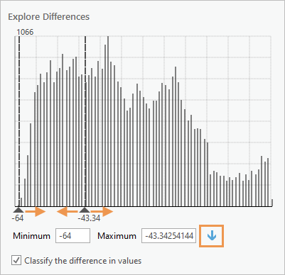

The Explore Differences section takes up the top half of the Classify Difference pane.
The Explore Differences section and interactive histogram
The histogram of difference values is displayed along with interactive handles for visualizing change. The Preview_Mask layer is added to the map by default when this pane is opened. When you drag the minimum and maximum histogram handles to different values in the histogram, the pixel values between the minimum and maximum are visible in the Preview_Mask layer on your map. All other pixel values are masked out and not visible. It may be easier to see the values if all other layers in the map are turned off. You can also modify the symbology of the Preview_Mask layer.
To skip classification and retain the original pixel value differences, uncheck the Classify the difference in values parameter, and click Next to move on to the next pane.
Use the interactive histogram to generate classes
To use the interactive histogram to generate classes, complete the following steps:
  1. Drag the minimum and maximum handles in the histogram until you have identified the change information that is important to your analysis (for example, strong negative change).
  2. Click the Add New Class button .
    The minimum and maximum values selected in the histogram are added as minimum and maximum class values in the Classify Output table at the bottom of the pane.
  3. In the Classify Output table, add the class value (an integer) to the Output field and the name of the class to the Class Name field.
