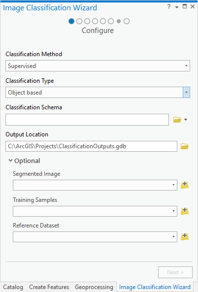

Configure
Click the Classification Wizard button on the Imagery tab to open and dock the wizard. The first page is the Configure page, where you set up your classification project. The parameters set here determine the steps and functionality available in the subsequent wizard pages.
Image Classification Wizard Configure page
Classification Method
There are two options for the method you will use to classify your imagery.
Option name
Description
Unsupervised
The outcome of the classification is determined without training samples. Pixels or segments are statistically assigned to a class based on the ISO Cluster classifier. Pixels are grouped into classes based on spectral and spatial characteristics. You provide the number of classes to compute, and the classes are identified and merged once the classification is complete.
Supervised
The outcome of the classification depends on the training samples provided. Training samples are representative sites for all the classes you want to classify in your image. These sites are stored as a point or polygon feature class with corresponding class names for each feature, and they are created or selected based on user knowledge of the source data and expected results. All other pixels in the image are classified using the characteristics of the training samples. This is the default option.
Classification Type
There are two options for the type of classification to use for both supervised and unsupervised classification.
Option name
Description
Pixel based
Classification is performed on a per-pixel basis, where the spectral characteristics of the individual pixel determines the class to which it is assigned. Characteristics of neighboring pixels are not considered in the pixel-based approach. This is considered the more traditional classification method, and can result in a speckled effect in the classified image.
Object based
Classification is performed on localized neighborhoods of pixels, grouped together with a process called segmentation. Segmentation takes into account both color and shape characteristics when grouping pixels into objects. The objects resulting from segmentation more closely resemble real-world features and produce cleaner classification results. This is the default option.
Classification Schema
A classification schema determines the number and types of classes to use for supervised classification. Schemas can be hierarchical, meaning there can be classes with subclasses. For example, you can specify a class of Forest with subclasses for Evergreen and Deciduous forests. A schema is saved in an Esri classification schema file (.ecs), which uses JSON syntax. You can choose from the following options to specify the classification schema:
  • Browse to an existing schema.
  • Generate a schema from an existing feature class representing training samples. Choose this if you plan to reference an existing training samples dataset.
  • Generate a schema from an existing raster class map.
  • Use the default schema from the National Land Cover Dataset for North America. If you want to create a custom schema, choose this option and modify it on the Training Sample Manager page.
Output Location
This is the workspace or directory that stores all of the outputs created in the Classification Wizard, including training data, segmented images, custom schemas, accuracy assessment information, and classification results.
Note:
All intermediate files created using the Classification Wizard are stored in the user temp directory. This is typically C:\Windows\Temp, but it may be different based on the operating system and access permissions.
Segmented Image
This is only an option if you selected Object based classification for Classification Type. If you have already created a segmented image, you can reference the existing dataset. Otherwise, you will create a segmented image as a step on the next page.
Note:
If the segmented raster has not been created previously, it will be created before training the classifier. This is a computer-intensive operation, and it may take a significant amount of time to create the segmented raster dataset. For large datasets, it is highly recommended that you create the segmented raster beforehand and specify it as an input when you configure your classification project.
Training Samples
This is only an option if you selected Supervised for Classification Method. You can create training samples using the Training Samples Manager pane in the Classification Tools drop-down list, or you can provide an existing training samples file. This can be either a shapefile or a feature class that contains your training samples, and it must correspond with the classification schema. The following field names are required in the training sample file:
  • classname—A text field indicating the name of the class category
  • classvalue—A long integer field containing the integer value for each class category
Note:
Training samples created in ArcGIS Desktop using the Image Classification toolbar are supported.
Reference Dataset
If you want to assess the accuracy of classified results, you need to provide a reference dataset. Reference data consists of features with a known location and class value, and it can be collected using a field survey, an existing class map or raster land base, or with higher-resolution imagery. The results of your image classification will be compared with your reference data for accuracy assessment. The classes in your reference dataset need to match your classification schema.
Reference data can be in one of the following formats:
  • A raster dataset that is a classified image.
  • A polygon feature class or a shapefile. The format of the feature class attribute table needs to match the training samples. To ensure this, you can create the reference dataset using the Training Samples Manager tools.
  • A point feature class or a shapefile. The format needs to match the output of the Create Accuracy Assessment tool. If you are using an existing file and want to convert it to the appropriate format, use the Create Accuracy Assessment Points geoprocessing tool.

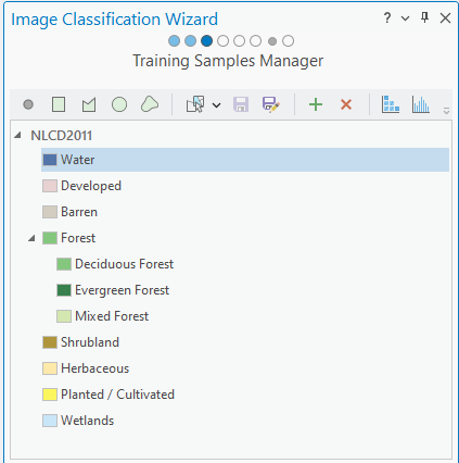

This page is only available if you select Supervised for Classification Method.
When the page opens, you can see the schema management section at the top, where the schema you selected on the Configure page is automatically loaded. You can create new classes here or remove existing classes to customize your schema. To create a new parent class at the highest level, select the name of your schema and click the Add New Class button. To create a subclass, select the parent class and click Add New Class. The subclass will be organized into the parent class. Right-click any of the classes to edit the class properties.
For more information regarding each tool in the toolbar, refer to the Use Training Samples Manager topic.
Training Samples Manager schema management

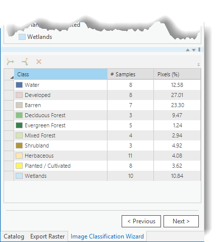

The bottom section of the page shows you all of the training samples for each class. You can select representative sites, or training samples, for each land-cover class in the image. A training sample has location information (polygon) and an associated land-cover class. The image classification algorithm uses the training samples, saved as a feature class, to identify the land-cover classes in the entire image. If you provided a training samples dataset on the Configure page, you will see your training samples listed here.
You can view and manage training samples by adding, grouping, or removing them. You can remove training samples individually, or you can group them together by selecting them and clicking the Delete button. When you select a training sample, it is selected on the map. Double-click a training sample in the table to zoom to it in the map.
Training Samples Manager list of training samples
To create training samples, complete the following steps:
  1. Select the class that you want to collect training samples for in the schema manager.
  2. Select one of the sketch tools or use the segment picker to begin collecting your training samples.
    1. To use the Segment Picker tool, the segmented image must be in the Contents pane. If you have more than one segmented layer in the Contents pane, use the drop-down list to select the segmented layer that you want to collect training samples from.
    2. Click the map to add the segment as a training sample.
    The individual training samples representing a class are listed in the Training Samples Manager.
  3. You can organize them by selecting multiple training samples and combining them into one class heading by clicking the Collapse button .
Note:
The training samples table lists the number of samples defining each class. If you used the segment picker tool to collect your training samples, the number of samples is the number of segments you selected to define the class. This is important to remember when you use a statistical classifier such as Maximum Likelihood, because the number of segments represents the total number of samples. For example, if eight segments were collected as training samples for a class, it may not be a statistically significant number of samples for reliable classification. However, if you collected the same training samples as pixels, your training sample may be represented by hundreds or thousands of pixels, which is a statistically significant number of samples.
The training samples table lists the percentage of pixels representing a class compared to the total number of pixels representing all classes. This percentage is important when using a statistical classifier such as Maximum Likelihood. The number and percentage of training samples is less important when using the nonparametric machine learning classifiers, such as Random Trees and Support Vector Machine.

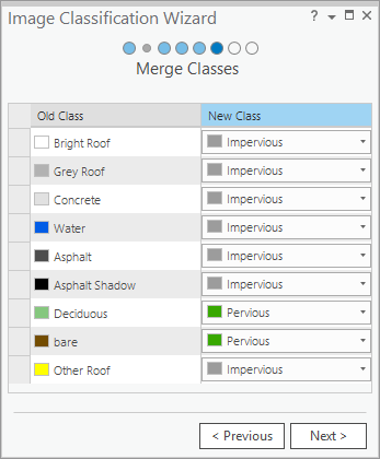

Merge Classes
After performing a supervised classification, you can merge multiple classes into broader classes. The original class names are listed in the Old Class column of the Merge Classes page. If you want to change an entire class you can do that here, but you are limited to the parent classes in your schema. For example, you can change deciduous to forest, but you can't change deciduous to water on this page. To make those types of edits, or to change individual features, use the Reclassifier page.

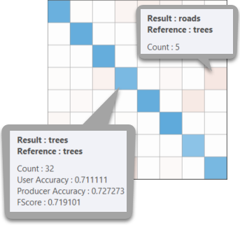

Analyzing the diagonal
Accuracy is represented from 0 to 1, with 1 being 100 percent accuracy. The colors range from light to dark blue, with darker blue meaning higher accuracy. Values along the diagonal represent overall accuracy of class assignment.
Accuracy assessment
Analyzing off the diagonal
Unlike the diagonal, the cells that are off the diagonal show errors based on omission and commission. Errors of omission refer to pixels or segments that were left out from the correct class in the classified image, so the true class was omitted or diminished in the classification. Errors of commission refer to the incorrect classification of pixels into a class, falsely increasing the size of the class. An error of omission in one class is counted as an error of commission in another class.
If you want to examine the error matrix values, load and open the output confusion matrix saved in your project or output folder. This error report, in .dbf format, lists the user and producer error for each class and includes the kappa statistic agreement for the overall accuracy.
