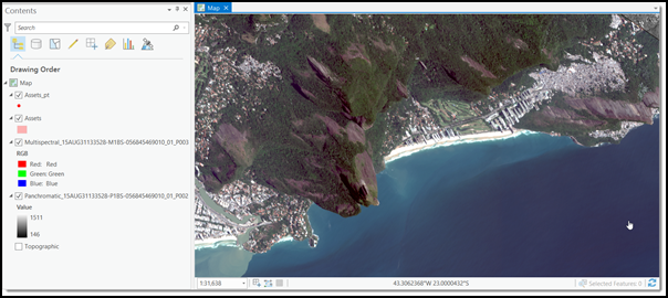

  1. Browse to C:\sampledata\dg-rio\ProProject and double-click the Rio-ImageSpaceAnalysis.aprx project file.
    ArcGIS Pro sets up the project environment and loads the imagery and feature class layers in the Contents pane. The imagery is displayed in standard cartographic map view, with north at the top.
    ICS project opens

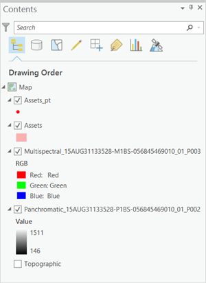

  2. Make sure the Contents pane appears with the five layers.
    Contents pane with imagery layers

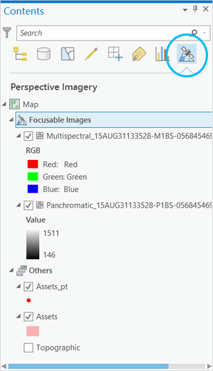

  3. In the Contents pane, click the List By Perspective Imagery button .
    The images are sorted based on focusable images. Focusable images are those eligible for display and analysis in image space as determined by required metadata associated with the imagery.
    List by Perspective Imagery button in the Contents pane
The focusable images are listed first under Focusable Images followed by other layers in the Contents pane.

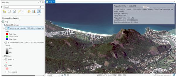

  1. Select the Multispectral_15AUG31133528-M1BS-056845469010_01_P003 layer in the Contents pane.
  2. Click the Set as focus image Off button to activate the image space view.
    The focus image button switches to Set as focus image On . The image no longer appears distorted, and can visualize the imagery from the perspective of the sensor.
    The map will have a heads-up display (HUD) window overlaid, which displays commonly required metadata pertaining to the imagery you're working with.
Focusable image with HUD
WorldView-2 satellite imagery courtesy of DigitalGlobe

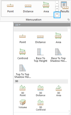

  2. On the Imagery tab, click the drop-down arrow to access the mensuration tools, which are located in the Mensuration group.
    Mensuration tools available from the Mensuration drop-down arrow
    The enabled tools depend on the metadata of the image layer selected in the Contents pane. For example, metadata needs to include sun angle and acquisition date to use the shadow measurement tools. See Making measurements using imagery for a table that outlines the metadata information required to enable each mensuration tool.

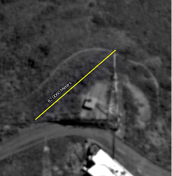

  3. Click the Top To Top Shadow Height tool button .
  4. Set two points—the first at the top of the tower structure and the other at the top of the shadow of the tower structure — as shown in the following image:
    Top To Top Shadow Height measurement of a tower structure in imagery

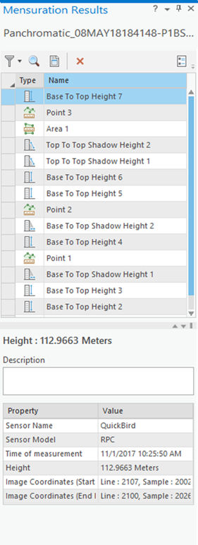

    The measurement result is shown on the map, along with the graphic. Review the measurement details in the Mensuration Results pane. Metadata associated with the image and measurement is also displayed.
    The Mensuration Results pane listing the image objects measured
  5. Select a measurement from the table, and press the F2 key to rename the measurement Name in the Mensuration Results pane.
  6. Add a measurement description in the Description text box in the pane.
  7. Click the Generate Report button to export the mensuration results to a text file on disk.
    Measurements are automatically saved in a feature dataset in the project geodatabase. The measurements are loaded automatically into the Mensuration Results pane when a project is loaded.

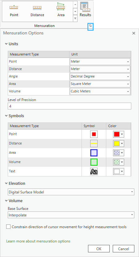

  8. Optionally click the options button in the Mensuration group to specify an elevation file to improve measurement accuracy. Browse to C:\sampledata\dg-rio\DEM and select the WorldSRTM30m.mrf file.
    Define a DEM to refine measurements using the options button in the Mensuration group
