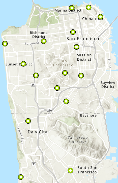

Candidate facilities are the potential places where you can open a store. You'll use the Candidate Stores feature class to add these candidate locations to the network analysis Facilities class. The solution from the location-allocation process will include a subset of these stores.
  1. On the Location-Allocation Layer tab, in the Input Data group, click Import Facilities .
    The Add Locations window appears.
  2. Make sure Input Network Analysis Layer is set to Location-Allocation and Sub Layer is set to Facilities.
  3. Click the drop-down arrow below Input Locations and choose CandidateStores. This is the point feature class you previously added to the map.
  4. Leave the default settings for the rest of the parameters, and click OK.
The 16 candidate stores load as facilities. These locations are drawn on the map with the candidate facility symbol.
Candidate stores loaded as facilities

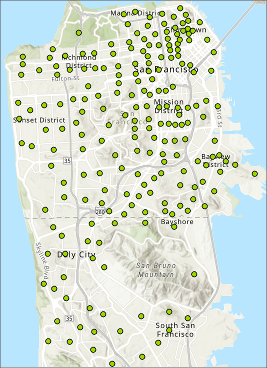

The stores need to be located to best serve the existing population. The Tract centroids point feature class will serve as the demand. The solution from the location-allocation process will allocate these demand locations to the chosen store.
  1. On the Location-Allocation Layer tab, in the Input Data group, click Import Demand Points .
  2. Make sure Input Network Analysis Layer is set to Location-Allocation and Sub Layer is set to Demand Points.
  3. Click the drop-down arrow for Input Locations and choose TractCentroids. This is the point feature class you previously added to the map.
  4. From Field Mappings > Property, choose Weight.
  5. From the Field Name drop-down list, choose POP2000.
  6. Leave the default settings for the rest of the parameters, and click OK.
The 208 Tract Centroids load as demand and the population at each location is mapped to the weight property for the demand. These locations are drawn on the map with the demand symbol.
Demand points

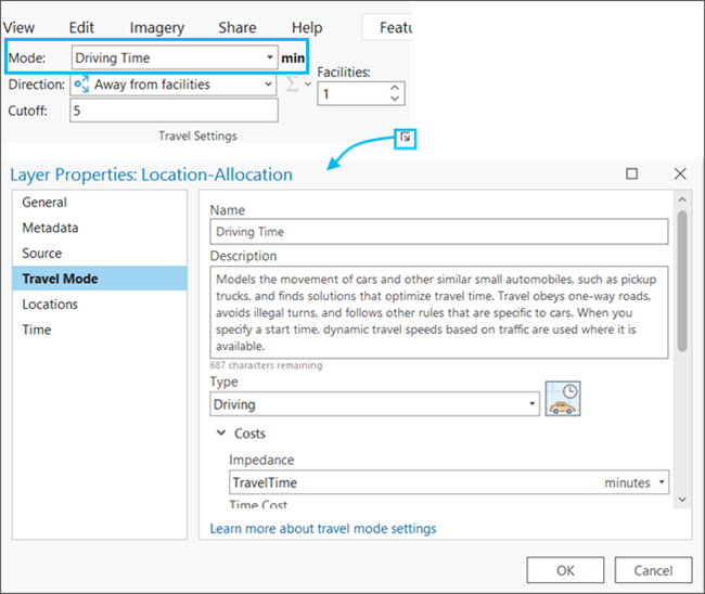

  2. In the Travel settings group, click the Facilities up arrow to 3. This will choose 3 out of the 16 candidate stores to optimally serve the 208 demand points.
  3. On the Location-Allocation Layer tab, in the Travel Settings group, in the Cutoff text box, type 5.
    This implies that people are not willing to travel more than 5 minutes to shop at these stores. The units for this cutoff value are in the units of the current impedance attribute. Since the current impedance is TravelTime, the units are in minutes.
The Driving Time travel mode uses the TravelTime cost attribute, which has units of minutes. Consequently, the Cutoff value is interpreted in units of minutes.
Learn more about the cost attribute
TravelTime cost attribute is storing the impedance value in minutes

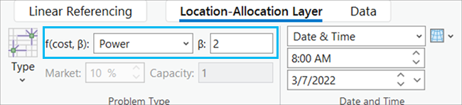

  2. On the Location-Allocation Layer tab, in the Problem Type group, click the arrow under Type and choose Maximize Market Share. Maximize Market Share computes the probability of customers visiting your facilities as well as competing facilities. It then chooses a set of facilities that maximizes your market share.
  3. On the Location-Allocation Layer tab, in the Problem Type group, click the arrow under Cost Transformation Function and change it from Linear to Power. The solver will now use a power decay distance function to determine the propensity to visit the store.
  4. Change the Cost Transformation Function Parameter from 1 to 2.
    Cost transformation beta decay parameter
    An impedance parameter of 2 on a power impedance transformation means the probability of visiting a store decays with the square of the distance between a demand point and a facility location. Usually, an accurate value of the impedance parameter is computed from other analyses, such as those provided using Esri Business Analyst Online.
