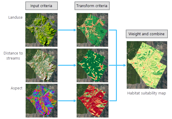

Habitat submodel
The habitat submodel identifies the best physical and abiotic conditions for bears to live in.
Conceptually, the steps for creating a submodel are the same as for creating any suitability model:
  1. Identify the criteria that bears are responding to. In this submodel, the criteria that determine the best physical and abiotic conditions are entered.
  2. Transform each criterion on the common suitability scale.
  3. Weight the criteria relative to one another.
  4. Combine the weighted transformed criteria.
When creating submodels, do not complete the locate step of the suitability modeling workflow. When identifying the best patches to conserve, the locate step will be performed once the submodels are combined.
Submodel to create the habitat suitability map
The habitat submodel that creates the habitat suitability map is shown.
In the habitat submodel, three criteria are transformed, weighted, and combined to create the habitat suitability map. The habitat suitability map identifies the relative preference of each location with respect to the physical conditions for bears to live in. The greener areas are most preferred.

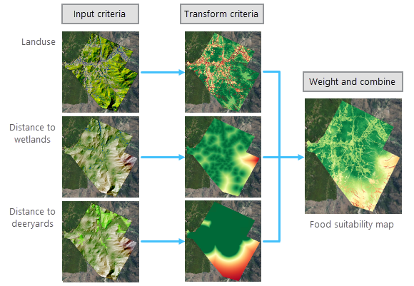

Food submodel
The food submodel identifies the areas where bears have the highest probability of finding food.
Submodel to create the food suitability map
The food submodel that creates the food suitability map is shown.
The food suitability map identifies for each location the relative probability for bears to find food. The greener areas have a higher probability of containing food. These areas are in the forests, and closer to wetlands and deeryards.

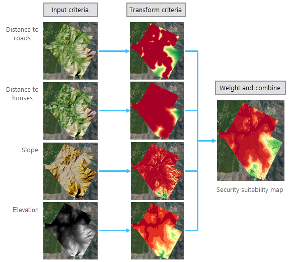

Security submodel
The security submodel identifies the areas that are the safest for bears.
Submodel to create the security suitability map
The security submodel that creates the security suitability map is shown.
The security suitability map identifies the relative safety of each location for bears. The safest areas are farther away from roads and houses, on steeper slopes, and in higher elevations.

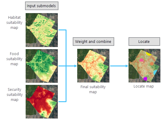

Model of submodels
The resulting suitability maps from each submodel rank the relative preference for each location in regard to the objective of that submodel. The suitability map from the habitat submodel identifies the most preferred areas for bears to live, the food submodel identifies the locations with the most food, and the security submodel identifies the areas that are safest.
The final suitability maps from each submodel are combined in a fourth suitability model.
Combining the habitat, food, and security submodels to create the final suitability and locate maps
The submodels are combined in a fourth suitability model to create the final suitability map.
The submodels are weighted and added together to create a final suitability map. The final suitability map identifies for each location how preferred it is while trading off the best areas to live, to find food, and that are the safest.
To identify the actual patches to conserve for bears, the locate step is applied. In addition to the preference for the attributes at each location, bears also have spatial requirements for those attributes. These include how much area bears need, the number of patches required, the shape of the patches, and how far apart the patches should be. The best areas meeting these requirements are determined from the suitability map.

Creating a model in the Suitability Modeler using submodels as input is similar to working with criteria. The main difference is you do not need to transform the input submodels since they are already on a common suitability scale.
When creating the input submodels, use the same suitability scale and weight method (multiplier or percent).
The input submodels may have a different number of criteria. When combining submodels that applied the multiplier weight method, the suitability map from the submodel with the greatest number of criteria will generally be more influential since its range will typically be larger. Adjust the weights of the input submodels to ensure that each influences the final suitability map in the desired manner.
