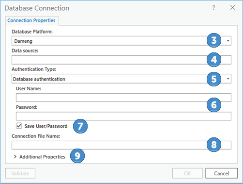

Follow the steps below to connect to a Dameng database using the Database Connection dialog box in ArcGIS Pro.
Open the Catalog pane in ArcGIS Pro.
Right-click Databases or a folder under Folders and click New Database Connection.
Choose Dameng from the Database Platform drop-down list.
In the Data source text box, provide the name of the server where Dameng is installed.
The Database authentication option is selected for the Authentication Type value. Operating system authentication is not supported.
Provide a valid username and password in the User name and Password text boxes, respectively.
Optionally, uncheck Save user name and password if you prefer not to save your login information as part of the connection.
Doing this can help maintain the security of the database. However, if you do this, you will be prompted to provide a username and password every time you connect.
Note:
Save user name and password must be checked for connection files that you register with an ArcGIS Server site and to search ArcGIS Pro to locate data accessed through this connection file.
Provide a name for the connection file in the Connection File Name field.
A default name is created based on the connection property values. You can use the default, or provide a more descriptive file name.
This is the name that will appear in the Catalog pane and view, and the name of the
.sdefile stored on disk.If Dameng communicates over a nondefault port, expand the Additional Properties section, choose tcp_port from the Property drop-down menu, and provide the port in the Value field.
Click OK to create the connection file.
A database connection appears under Databases in the Catalog pane, and a connection file (.sde) is created in the ArcGIS Pro project directory.
