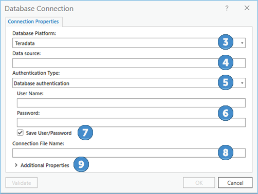

Follow the steps below to connect to Teradata using the Database Connection dialog box in ArcGIS Pro.
The Database Connection dialog box
  1. Open the Catalog pane in ArcGIS Pro.
  2. Right-click Databases or a folder under Folders and click New Database Connection.
  3. Choose Teradata from the Database Platform drop-down list.
  4. In the Data source text box, type the IP address of the Teradata server.
    For example, if the server has an IPV4 address of 200.30.200.10, type 200.30.200.10. If the server has an IPV6 address, enclose the address in brackets. For example, for a server with an IPV6 address of 3020:12z3:y4xw:5099:0:v678:u111:ts22, type [3020:12z3:y4xw:5099:0:v678:u111:ts22].
    The Authentication Type option is set to Database authentication, because operating system authentication is not supported.
  5. Provide a valid database username and password in the User name and Password text boxes, respectively.
  6. Uncheck Save user name and password if you prefer not to save your login information as part of the connection.
    Doing this can help maintain the security of the database. However, if you do this, you will be prompted to provide a username and password every time you connect from ArcGIS Pro.
    Note:
    Save user name and password must be checked for connection files that you register with an ArcGIS Server site or if you want to search to locate data accessed through this connection file.
  7. Provide a name for the connection file in the Connection File Name field.
    A default name is created based on the connection property values. You can use the default, or provide a more descriptive file name.
    This is the name that will appear in the Catalog pane and view, and the name of the .sde file stored on disk.
  8. If you require additional parameters to connect to the database—such as a nondefault port—expand the Additional Properties section, type the parameter in the Property field and type the corresponding property setting in the Value field.
    Read the Teradata documentation for information about additional connection parameters.
  9. Click OK to create the connection file.
A database connection appears under Databases in the Catalog pane, and a connection file (.sde) is created in the ArcGIS Pro project directory.
