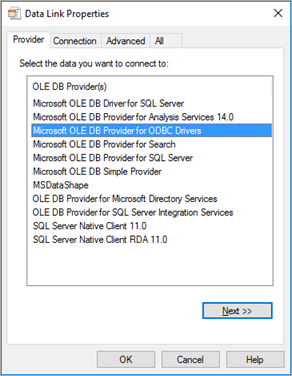

    Data Link Properties dialog box
  3. On the Provider tab, click the appropriate OLE DB provider for the type of data you want to use.
  4. Click Next or click the Connection tab.
