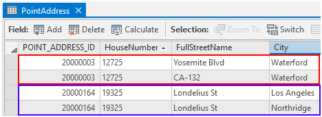

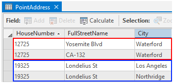

Reference data can be formatted to contain duplicate features that represent the same location, but with different attributes, as a way of creating a locator that supports alternate names. This is illustrated in the data below, in which 12725 Yosemite Blvd, Waterford and 12725 CA-132, Waterford have the same geometry but different values in the FullStreetName field.
PointAddress attribute table with duplicate features for the same location with different names

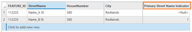

When the primary reference data has duplicate features with different street name values and you want to specify which street name is the primary name, the reference data must have a field that contains a flag that indicates which street name is going to be the primary name returned when geocoding. This field must be mapped to the Primary Street Name Indicator field from the locator role, such as PrimaryStreetFlag. If the Feature ID is mapped, the Primary Street Name Indicator field is used to define Preferred Street Name of features with the same Feature ID. If the Feature ID is not mapped, each street name from the primary reference data is marked as Primary because de-duplication will not work and each street name is stored independently.
Feature class attribute table with Feature ID and Primary Street Name Indicator

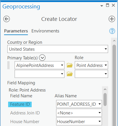

The Create Locator tool uses the values mapped to the Feature ID field to skip all duplicate geometries, except the first geometry that is encountered, which is stored in the locator. The alternate attribute values are created based on the matching IDs of the duplicate features.
POINT_ADDRESS_ID field assigned to the Feature ID locator role field in the Create Locator tool
