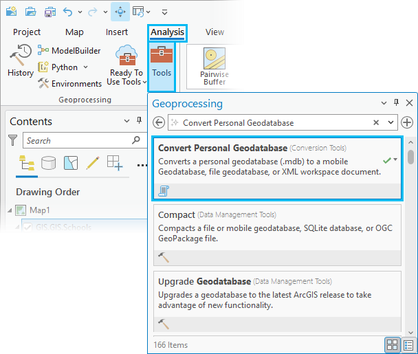

  1. On the Analysis tab, in the Geoprocessing group, click Tools to open the Geoprocessing pane.
    Convert Personal Geodatabase tool under Analysis tab, Tools, and Geoprocessing
  2. In the Geoprocessing pane, search for and select Convert Personal Geodatabase.

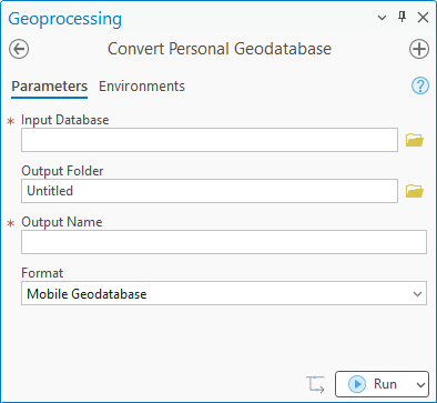

    The tool dialog box opens with the default settings visible.
    Convert Personal Geodatabase geoprocessing tool dialog box
  3. For the Input Database parameter, click the Browse button and select the personal geodatabase (.mdb) or Microsoft Access database (.accdb) to convert.
    Note:
    Personal geodatabases are not supported in ArcGIS Pro, so .mdb files and their contents do not appear in the Catalog pane. As a result, the only way to select an .mdb file in ArcGIS Pro is when using the Browse button to select the Input Database parameter from this Convert Personal Geodatabase geoprocessing tool.
  4. For the Output Folder parameter, click the Browse button and select an existing output folder where the new mobile geodatabase, file geodatabase, or XML workspace document will be created.
    This parameter defaults to the ArcGIS Pro home folder location.
  5. For the Output Name parameter, type a name for the output geodatabase or XML document to be created.
    By default, this parameter will match the name of the Input Database value.
  6. For the Format parameter, choose one of the following output format types that the personal geodatabase file (.mdb) or the Microsoft Access database file (.accdb) will be converted to:
    • Mobile Geodatabase—The tool will create a mobile geodatabase (.geodatabase) file from the input database. This is the default.
    • File Geodatabase—The tool will create a file geodatabase file (.gdb) from the input database.
    • XML Workspace Document—The tool will create an XML workspace document (.xml) from the input database.
      Tip:
      You can later use the Import XML Workspace Document tool to import this resulting .xml file into another geodatabase or enterprise geodatabase.
  7. Click the Run button at the bottom of the Geoprocessing pane to start the conversion process.
