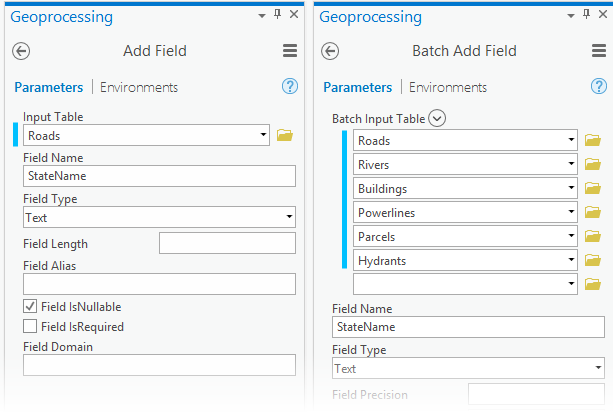

For example, to add a field with the same name to several datasets, complete the following steps:
  1. Right-click the Add Field tool and select Batch.
  2. Select Input Table as the batch parameter and click Next.
    The Batch Add Field tool opens
  3. For the Batch Input Table parameter, browse to and select any dataset where the new field will be added.
  4. Provide the new field name and type, and any other necessary parameter settings.
  5. Run the Batch Add Field tool.
Add Field and Batch Add Field tool parameters
The Add Field tool only supports one input table. The Batch Add Field tool supports multiple input tables. Each of the specified input tables will have the StateName field added.

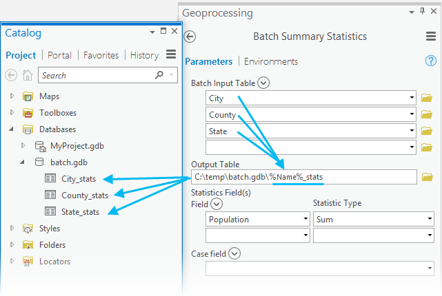

Dynamic output naming
Most geoprocessing tools create an output dataset. When running a tool in batch mode, the naming of the tool's output datasets must receive special consideration so that a unique name is used for every iteration of the batch tool.
Batch tool outputs are dynamically named using the %Name% variable in output parameters. The %Name% variable is automatically included in every output dataset parameter. It can be manually added to other parameters that should use dynamic naming.
The %Name% variable is replaced by the value in the batch parameter during each iteration. If the value in the batch parameter contains spaces or special characters, they are replaced with an underscore. If the value is a path to a dataset, only the dataset name is used.
Note:
If you do not use the %Name% variable in the output dataset path, the same dataset path will be used for each iteration, resulting in each iteration overwriting the output of the previous iteration. This does not apply to tools that update or modify the input dataset.
For example, if a batch tool's output is set to %Name%_stats, and the Batch Input Table parameter contains tables named City, County, and State, the batch tool will create three outputs, each named after one of the inputs: City_stats, County_stats, and State_stats.
