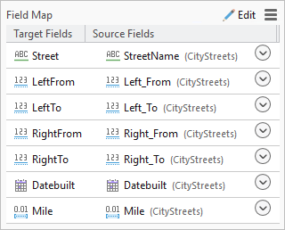

Append tool field map parameter
The field map parameter in the Append tool displays target fields from the target dataset and source fields from the input dataset. Target fields and source fields with the same name are automatically mapped.
List of Target and Source fields in the Append tool field map parameter
Target fields cannot be added, removed, or reordered. Source fields from the input dataset can be added, removed and reordered.

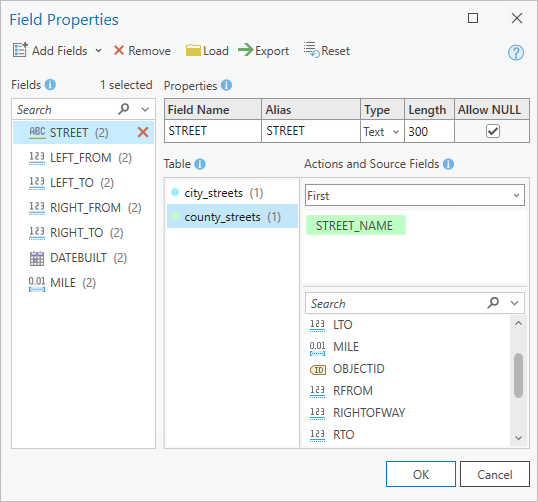

Field properties
Open the Field Properties window to view or modify the properties of a selected field, and perform field mapping or matching tasks by selecting one or more source fields and actions.
The Field Properties window contains four sections:
  • Fields—Select a field to view or modify its properties and source fields.
  • Properties—View or modify the selected field's properties.
  • Table—View or switch between datasets.
  • Actions and Source Fields—View or edit the source fields and choose an action to perform on the selected source fields.
Use the Field Properties window to perform tasks such as adding and removing fields, loading or exporting the field map, or resetting the field map.
Fields
The Fields section lists the fields that will be processed and written when you run a tool. Select a field to view or modify its properties and source fields. Fields can be added, removed, and reordered.

To match attribute fields from an input dataset, complete the following steps:
  1. Click the Edit button to open the Field Properties window.
  2. In the Fields section, select an existing field, or click the Add fields drop-down menu and click Add Empty Field to add a new blank field.
  3. In the Properties section, view or edit the properties of the selected field.
  4. If applicable, use the Table section to select a dataset to view the list of available input fields under Actions and Source Fields.
  5. In the Actions and Source Fields section, select a field from the list of available input fields to use as a source field, and choose an action to determine how the values from one or multiple source fields are transferred to the output field.
    The selected source field appears as a tag above the input fields list.
  6. Click OK to confirm the changes made to the field map.
