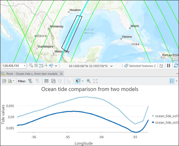

Use the Multiple variables with one track option to compare the variable changes along one trajectory. You can visualize the pattern of change for the different variables.
Trajectory variable differences
Differences of the ocean tide variables at the selected trajectory are shown, calculated using two models.
